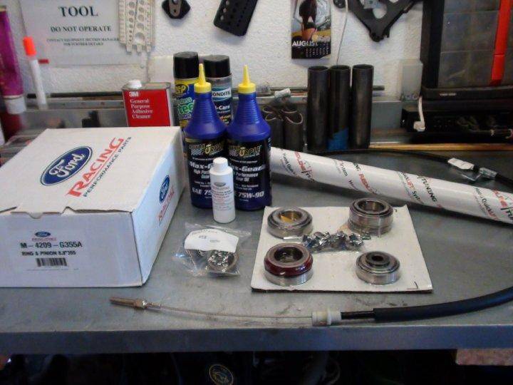

Buy the "Ratech" full installation kit. Mustangsunlimited sells them. I bought FORD racing from them and it came in a Ratech box with a Ford sticker. I thought they were trying to pull a fast one so I called Ford. They said Ratech does make the installation kit for them, and that the box would be from Ratech with a Ford sticker.
That's all fine and dandy but the Ratech kit without the sticker is $50 less, so save your $50 and buy the Ratech kit, they literally are the exact same kit. Ford racing verified that to me. Hope this helps.
BTW... Buyfordracing.com sells cheap Ford racing gears, but not in 4.56. They sell 4.10's for $139 with free shipping.
What you will need aside from the gears themselves:
Inner and outter pinion bearings w/races
Pinion seal
Crush washer/sleeve
Pinion nut
Pinion shims
Carrier shims
Carrier bearings x2
Outter case bearings x2 w/races
Outter case seals x2
Friction modifier if you have LSD
Gear oil, you can also buy this with friction modifier in it already
Ultra black sealant
red lock tight
Slotted carrier pin if your using a gear steeper than a 4.10
Carrier pin retaining bolt, these are very common to snap off in the carrier, have fun with that!!!!
Gear marker for checking pattern
If you have an 8.8 LSD, now is the time for a CF clutch kit $50
Tools you will need that you probably don't own:
Pinion depth tool, guage and bar
Dial indiacator for setting back lash
Calipers
Bar type, inch pound torque wrench
Torque wrench
20 ton press, with adaptors
MAP gas torch
Bearing splitter
Long stroke air hammer/chisel
Case spreader
Slide hammer w/inner bearing/axle bearing adapter tip
IF you have an 8.8 LSD you will need a tool for installing the clutch spring, I have made a custom tool for this.
