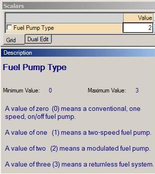

To continue the discussion on fuel pump types, this pic is from my SCT Pro-Racer package tune for my BTC0 PCM.
Stock, the fuel pump type is set to 2.
I wonder if using a conventional Walbro pump, and setting the type to 0, would work.
Also interesting is that stock on a '98 Cobra AOL3 PCM, this value is 1. :confused:
Just because you change the number doesn't necessarily mean it changes what other modules in the car do... you know what I mean?
Yes, I agree. You'd probably have to also directly wire the Walbro, bypassing the FPDM. Or perhaps, the FPDM output would change depending upon this setting. The only way to know would be to test the FPDM output, or have access to the Ford PCM documentation.
Are you sure the cobra doesn't have high and low speeds?
I know that it does, but I was expecting the Mark VIII and Cobra settings to be the same, since the fuel pump issues are similar, although the '98 Cobra does not have a FPDM. What the Cobra has is a big resistor to drop the voltage to the pump during "low speed" operation.

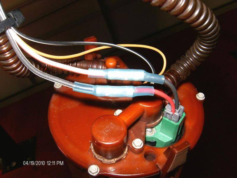

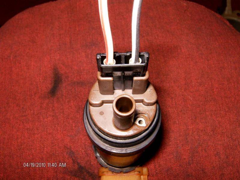

You do not switch the polarity! Read my earlier post with the pictures.

Please look very closely at these pictures. In the first, you can see the stock wires, and the polarity, as they are connected to the stock pump.
And in the other pic, you can see the correct wiring for the SVT Focus pump.
It just seems like it's reversed because you have to connect the red wire (+) from the Focus pump to the black w/white tracer (+), and the black wire (-) from the Focus pump to the white w/red tracer (-) wire, from the stock plug, but the polarity remains the same!
Let's please stop posting incorrect information. Otherwise, some poor schmuck, who can see the little + and - on the stock pump, really will reverse the polarity, and then he'll have to drop the tank again. :eek:
