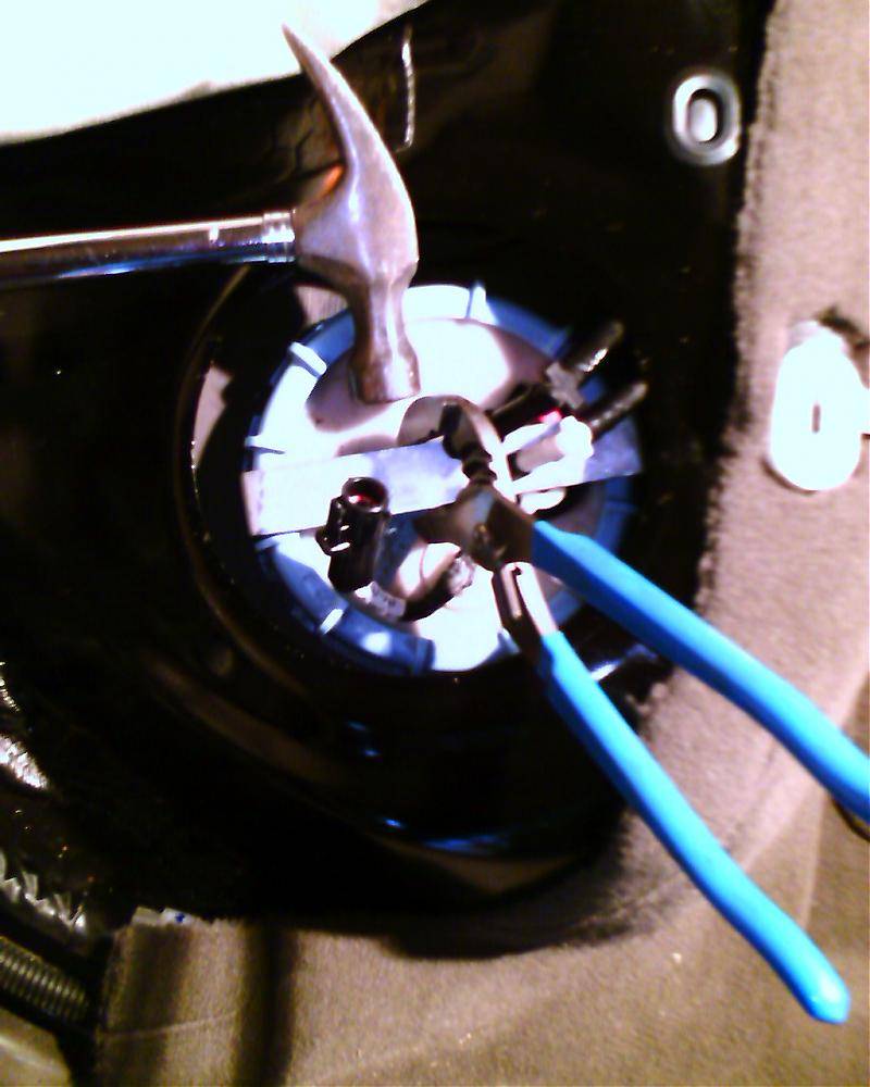

I'm about to go down this street now. I am about to go try to remove the fuel lines. What I need to know is how did you remove the blue plastic ring that is holding it all in place?

Nobody has explained how to actually remove the big blue fuel pump ring WITHOUT using the 'specialized' tool to remove it. It won't budge at all but I know that there has to be another way to get this frickin thing off.
I cut a piece of bar metal from home depot - and bend each end down at a 90 degree - so it fits across the top of the blue ring and the bend end lock onto the grooves. You then grab the center of it with some big plyers to get leverage and twist..... make sure you do not create any sparks, and have all the hoses, electrical undone and tucked away. I used vacuum caps to cap off and plug the lines and openings in the pump top.
you have to cut the OE fuel line off the pump - so to replace it you have to use the proper fuel line.
if you use rubber fuel hose - it needs to be J30R10 hose (it can be submerged in the tank) - regular fuel line is not meant to be in gas, the outter casing deteriorates, bloats up and falls apart. YOu can buy J30R10 hose from Gates - it's nearly $20 per foot.
My second time - I used the actual same hose as stock. here - > http://www.autoperformanceengineering.com/html/kits.html the flex hose comes in 8" and 15" - much, much, much better solution.
