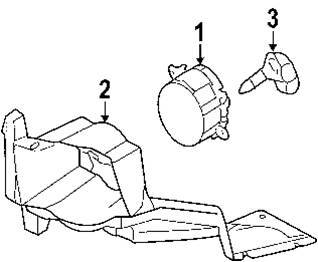

So my new bumper (LSE) will be here tomorrow and I'd like to order the fog lamp "stuff" so they get here while I'm painting the bumper.
I went to Tasca and according to the pic, I need:
1) Fog lamp assy W/SPORT PACKAGE Left $34.62
1) Fog lamp assy W/SPORT PACKAGE Right $34.62
2) Fog lamp assy mount bracket W/SPORT PACKAGE Right $37.92
2) Fog lamp assy mount bracket W/SPORT PACKAGE Left $37.92
3) And obviously I need the bulb.

2. When I ordered new fog light housing it came with bulbs, but that was off ebay. The standard bulbs will not match your HIDs, they'll be yellow. If you want the bulbs to match get HID or Leds.
3. Its possible, I've changed out one of my brackets with the bumper still on. I think the bracket helps hold the bumper in place. It might be a bit floppy without it.
That stuff is correct. I think the fog assemblies may come with bulbs already. But if you want HIDs just order a kit.
You can put the fog brackets on with the bumper installed; however the LSE bumper is partially held on via these brackets. The wheel well liner attaches to the bracket. So don't go too crazy driving with fogless bumper.
I recommend having it painted before installed the bumper anyways. So if you can hold off and do it all at once, I suggest that.
