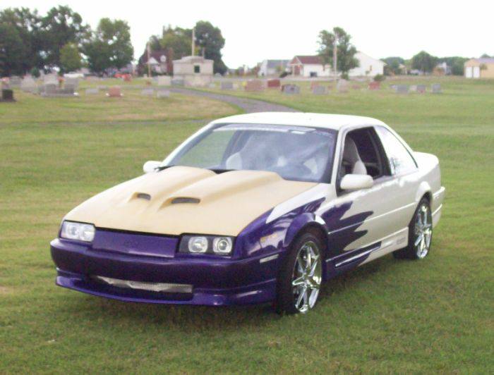

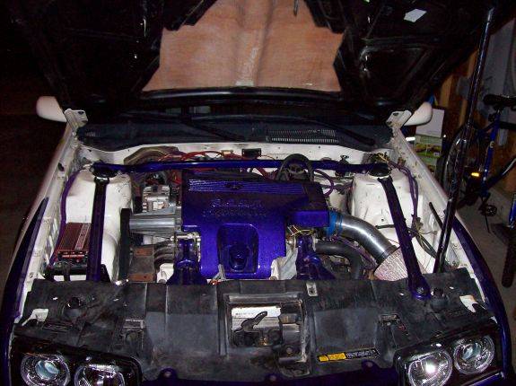

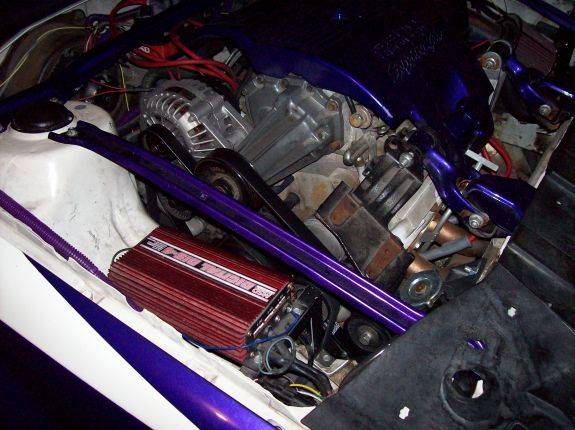

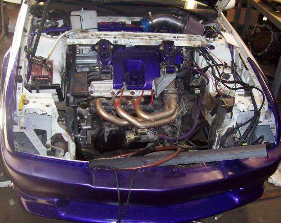

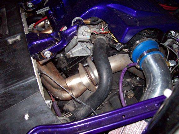

Shed a little light on the topic. I have experience in doing swaps that people say can't be done. I did a 3800sc/auto swap into a '91 Chevy Beretta GTZ. The original motor was a 3.1/auto. I have about an inch of clearance from each strut tower. The radiator had to be moved forward to make room for the headers. The frame had to be cut to make to custom mounts for the 3800sc. The mounts had to sit low enough for the hood to close. Due to the fact no hood existed to cover the supercharger. I had to run a stand alone management unit made by Simple Digital Systems to run the 3800sc. I still have the factory cumputer in the car running everything expect the motor. The SDS unit does that. The BIG benefit of the unit allows me to do a bolt-on mod and have the computer reprogrammed the same day. No pulling it to send it off somewhere or having to hook-up a laptop. I can reprogram it in minutes. I am surprised the engineers didn't try to isolate the motor on a se[erate unit and let the factory unit manage the car functions.:confused: but then again maybe they did and just couldn't get it to work. With the amount of electronics in the LS anything is possible to cause the problem.
BTW a few pictures of my swap. Note the hood. One off fully functional. I made it myself. Molded fiberglass hoodscoop to new hood. Had to make two of these. Some scumbag thief helped himself to the first one. $100 reward for leads to its return. Will only fit a Beretta.:)

I don't think anyone is saying it can't be done, just that it's not as simple as it's being made out to be. And even a torch, welder, JB Weld, and duct tape won't help with this swap; physically mounting the engine isn't the big problem. Integrating all the electronic systems is the big hairy freakin' deal.
It's like the deal with the THX/Nav retrofit--it can be done, but you're probably better off doing something else. F'rinstance, if you take the price of an LS and add the $11K being bandied about, you're probably not too far from the price of a nice eqivalent S-Type, or maybe even an older S-Type R, which will have non-jury rigged performance.
