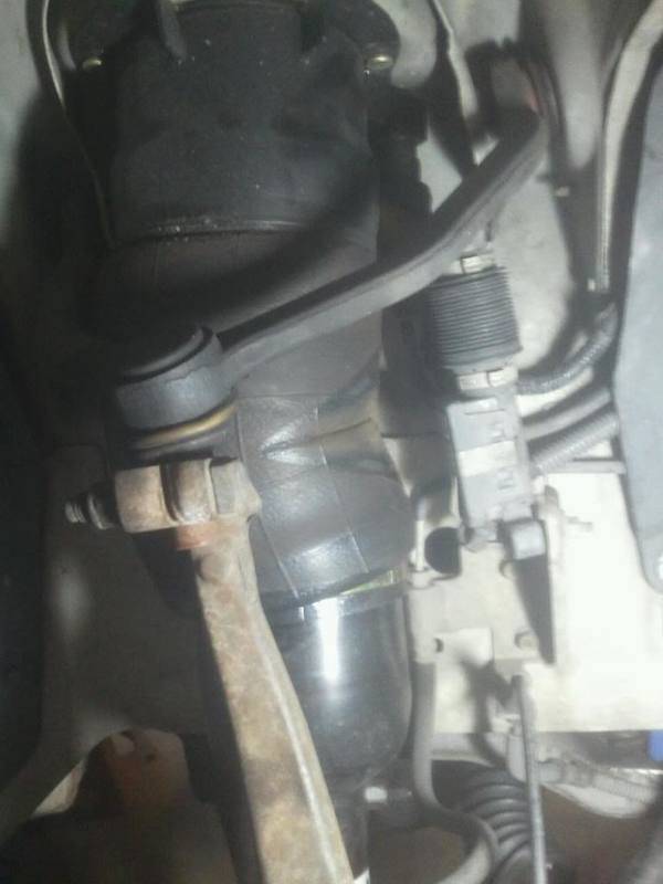

I'm going to spare you the details of all the junk I've gone through with my air ride system, but the matter at hand has to do with changing a lower front control arm I suppose. I did so about a month or two ago. I jacked my car up to change the oil and notice the Right front air spring had creased about half way up. It looked like the middle of the spring was being pushed rearward.
I removed all the air from the spring, and got the crease out, but now the bottom of the spring rolled up and I can see the metal band that holds the rubber to the metal on the bottom. Any ideas on how to fix this??
Pic would indeed help. Usually when they are pumped full of air they adjust correctly. When I got my new ones they looked weird. Then I got some air in them.
I am more concerned about you bag being "bent", if I am reading that right.
he put one up on facebook.

Yeah, I am considering taking it off and opening it up, assuming I can find someone who can re seal it.

So American Air gets them from other companies? I'm trying to get to shop today so I can pull bag off and get it in todays mail. I really want to find a temporary bag for not very much, as it will be TEMPORARY. I do need something reliable, and hopefully near Houston.
I intend to either order a new one from somewhere, or do a conversion soon, but I need to get the car driveable for now. Is there a good way to just put the coils in the front? I don't know enough about the computer system as of now.
