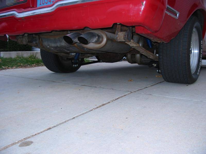

Same as the one used as a mid muffler on Marks by many. 2 1/2", 2 in 2 out x inside. I obviously didn't need a x muffler at the bumper but thats the one that fit best.

Ok, I gotchya now. Had me confused there for a minute. I'm going with dual in / dual out muffled X and two Magnaflow mufflers in the back with (Pypes) tips to keep mine low toned, until it's punched on and even then, it's not very loud but it is heard. I was just on eBay about to order the 2.5" SS pipe kit and I should have all this in within a week or two tops.
So do you have any X at all in the middle or just two at the back on each side? It just seems a little loud back there if that's a muffled X in the rear. I'm not knocking the sound so, don't take what I'm saying the wrong way. Just still a little confused as to what you have and how it's all setup.
A single DIDO at the rear of a Mark.... no
My VIII exhaust is stock LSC issue except for the tips.

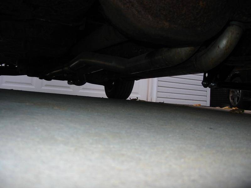

Now I see how it's setup. I'm taking it that the X you have just after the headers is an open X and not the same as you have in the back? I never would have thought I'd see a Magnaflow muffled X at the rear of a car lol. This is the one I'm going with in the middle. Part# 14386

Yeah just a X after the headers. No way in he11 you'd get a muffer under there not that I would want it without it sitting on the ground.
I believe the muffler is a 5x8 so it might not be the exact one your going to run.
