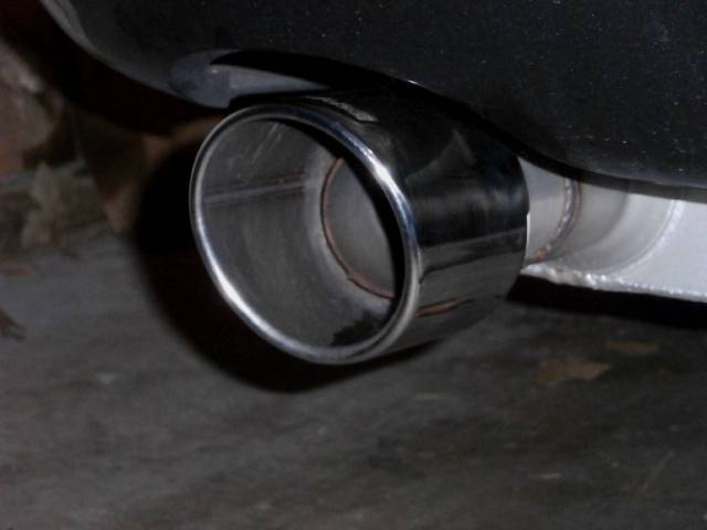

the first shop i went to told me they would not cut the 3rd cat, and if I did it then brought it to them to add exhaust, they didn't want to be involved....the 2nd place I went to, they cut it out, and put it back together- true 2.5'' duals...but that clown also told me a crossover, H, or any scavenging blend would be a waste, so he did none of those... eventually I got the first place to clean up his mess; I STILL have a droopy RH tip to get reset

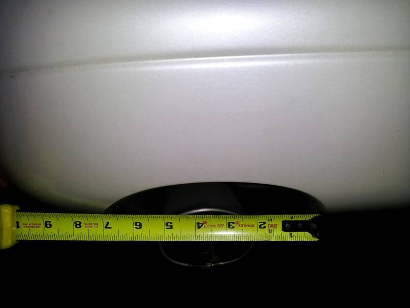

I really would like to see your cutout up close because it might just be my eyes but yours appears to be more rounded looking at the top and not as wide as the other cutouts I have seen on a Gen 1. If possible, do you think you could get a measurement from one side of the cutout to the other? I'm trying to figure out if they're the same or maybe there was a difference in years. I'll measure mine and get a pic of it being measured from the beginning of the cutout to the ending of the cutout. Just looking at yours seems to show a lot of roundness at the top where mine has a small section of flatness (kinda) before curving again. I'll measure it before the night is out.

... you could get a measurement from one side of the cutout to the other?

the length/width of my elipse is nominally 6 5/8''...can't really measure the elevation of the apex (vert dimension)..

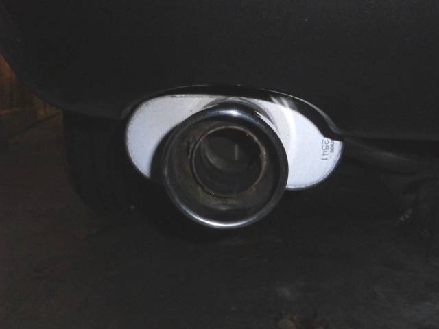

here's some pix
I think because my paint is dark-colored the cutout assumes the shape of the tip...round

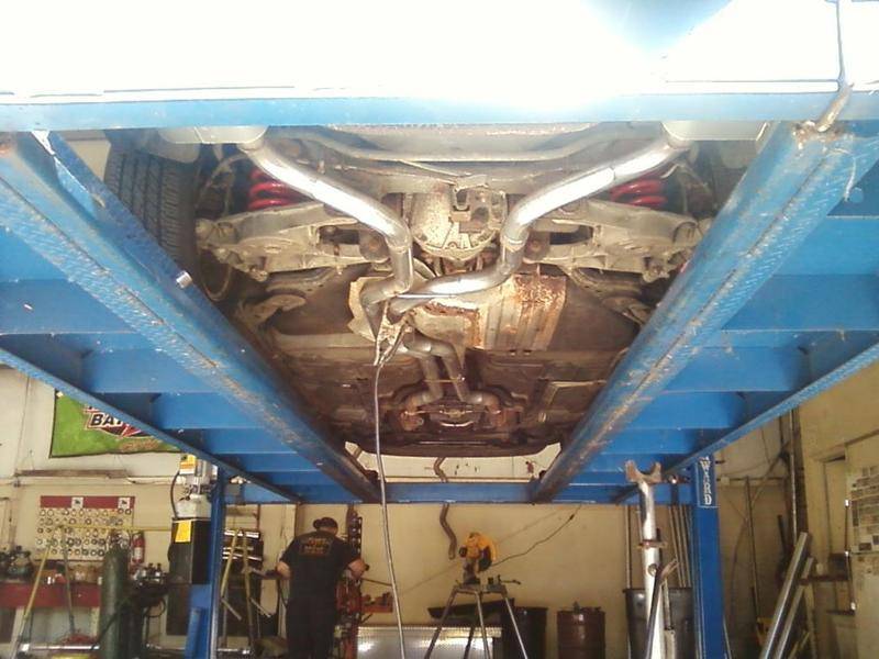

patience...someone will do it.....the second shop I talked to cut it out and did the true duals....$250 for labor and pipes...we're 3 hours apart
(before I got the x)
