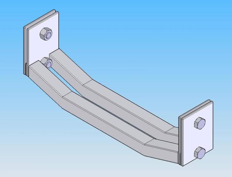

Laser, what size are the bars on the front braces? 1x1?
I ordered the same rear brace last week, they shipped today. SCP was closed for the holidays :(
I believe they are 1"x1"

Have my IRS Crossmember drawn up...
Hopefully finish the front brace drawings tonight, and pick up stock on Saturday. :)
Hmmm....I think I need to drill my lower mounting place for the rear brace. I only have one bolt in each side for now. Tends to move every now-n-then.
