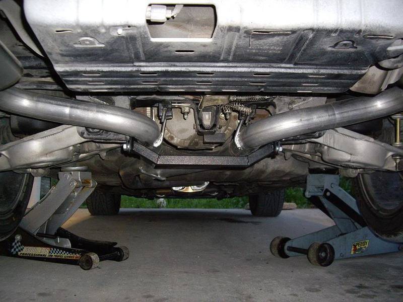

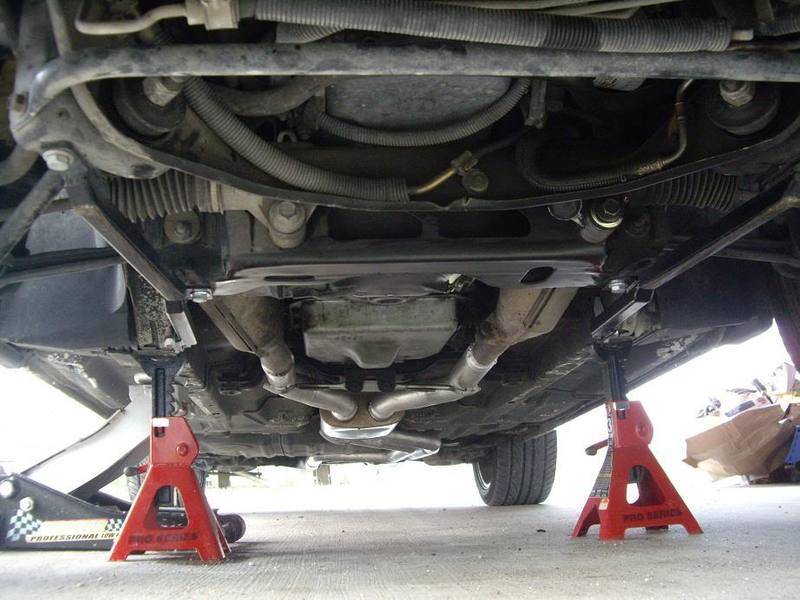

I can not believe how much better the entire car is with all the SCP braces! I did the front support braces several months back and was plesantly suprised with them. Well just last night I bolted up the firewall brace in anticipation of having it welded on today. I also installed the SCP IRS brace and its one of the greatest mods I did to my car. It was simple to install, cheap and works perfect! The quality and precision of the part is really incrediable for such a low production hand made piece.
So this morning I leave the house and hammer some corners to see if I could feel a difference with just the IRS brace as my front braces still need to be welded. I could feel the rear of the car bite through the turn like never before. I started pushing it harder and it just continued to stay planted. I gave up trying to kick the tail out after my g-meter said 1.01g's and I started to get nauseaus. :lol: The car can go so fast through a turn it started to scare me. I did have some push on the nose but am addressing that.
After I was done playing around and hit the highway I noticed yet another benifit. The cars rear rides SOOOOOO much better now! Wasnt expecting that! I know why it rides better, its cause the shocks and springs now have total controll where as before the LCA mounts could flex before the shock would dampen the impacts of expansion joints.
Fast lane changes are also 20x better. We all have felt the tail wiggle some when changing lanes fast and accelerating hard, well no more! It is rock freakin solid!

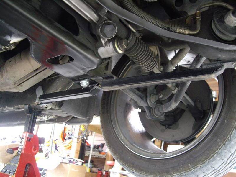

Then when I got to Waco I had the front firewall to k-member braces welded in and yet again was shocked by the difference! Front end bites hard and the steering dont wobble when you hit bigger bumps now. Got rid of 60% of the push and my new sway bar should help with the rest.
Excellent mods for very little cash and the quality is superb!

OK so here is how the IRS brace helps make the car handle better. By bracing the LCA mounts to each other that keeps the rear outside tire from going into positive camber during hard turns since that mount no longer flexes inward. That also eliminates it from adding toe out during the corner. With the toe out the car feels like its sliding and you get front end push.
Now you no longer have that issue. :) Also since the LCA mounts dont flex that meens the shock can now do its job and absorb impacts instead of the mount flexing first.
With the front end braces the k-member is now positivly located. What that allows is for the k-member to no longer move foreward or back which eliminated the toe and caster change during bumps and hard cornering. It makes the steering much more predictable and allows for much less heading corrections while in a corner. That meens higher speeds as you can smothly track a turn and not upset the cars balence by adjusting the steering input angle cause the car changed it because the k-member flexed backward causeing it to reduce caster and have too much toe in.
I hope this helps some people here. I would have never believed how much better these simple pieces made the car behave if I didnt see first hand. They are worth their weight in gold and if I buy another Mark they will be my very first mod.

Thats going to be killer on your rear tires with that much rear camber. (when it lowers it will get worse too!)
You can go another 1.25* with the caster too and still be in spec. (or more if you want!)
Great info about the braces, I'll have to get some someday :)
The 1.2 is at the lowered setting. At normal around town height its at .7* negative. And its fine, if you saw my last couple sets of tires you can see they wore in the center (last pair) and the ones before wore even across the face.
And I am fine at 5* caster. Car tracks great.

mmm looks great! I've been tossing around the idea of building a rear brace. and now that I see how the front ones work and are made,I just might do that too! :D
You car looks great as always man.
The rear can be a strong bar to fit between the shock mount
