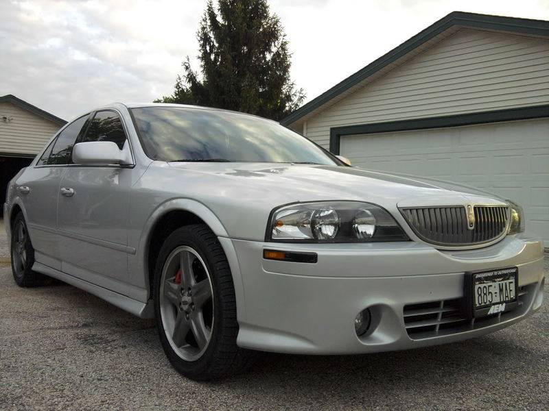

Finished product! Headlights no longer ugly! ;)
Chrome turn signal bulbs are in order!! I picked up a pair from DDM for like $7.00 IIRC. Trust me you bwill glad you did it!

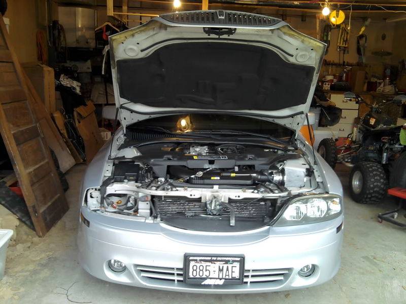

I had to go to Ace hardware 2mi down the road to pick up amber bulbs with one headlight in haha! I thought for sure I had the bulbs laying around but I couldn't find them when the time came.

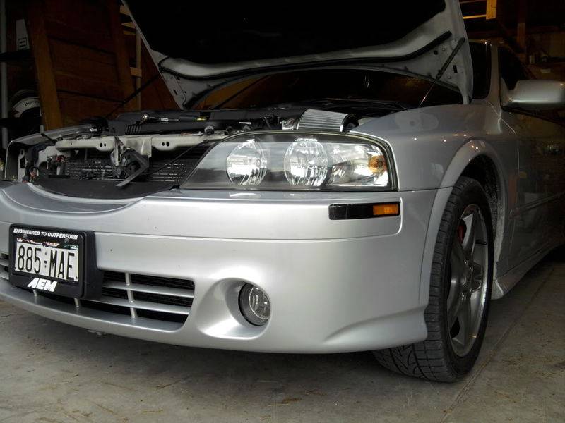

I also figured I'd lessen the amount of amber shown from the marker lights on the bumper. Had some tint laying around so I popped them out and shrink wrapped it to the marker. Turned out pretty decent but I might change it not sure yet

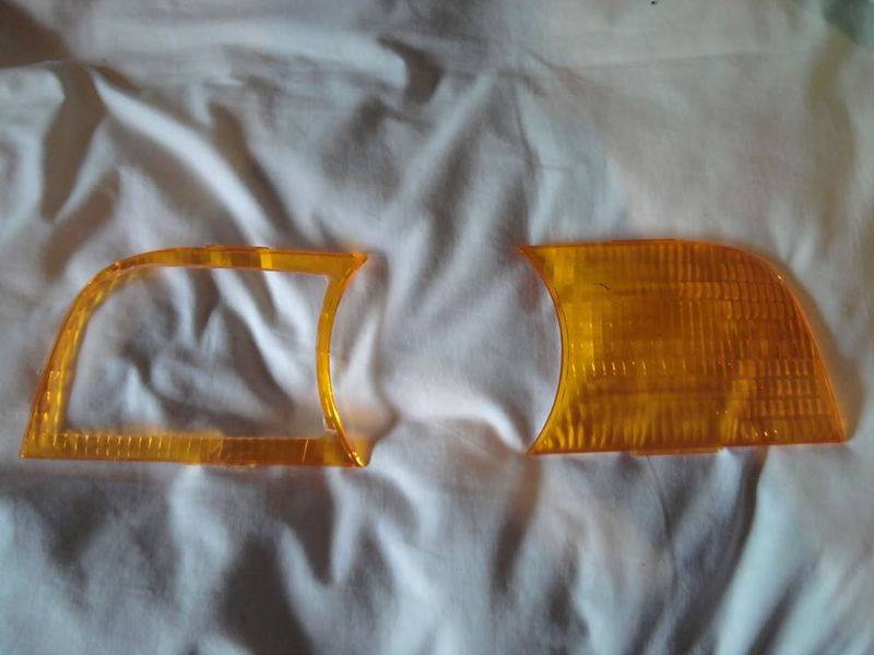

Also toying around with this idea. I'd like to paint the edges black when I'm done perfecting the cuts
Does that mean you are thinking about taking them apart again to put the modified amber piece back in? I think it looks flawless the way you have it. JMO
Jorge
I was thinking about it for a unique look. But to be honest I'm pretty satisfied as it is now. I probably won't take them apart again unless I have to. Angel eyes or condensation issues down the road..who knows haha

Cutting them really wasn't bad in my opinion. I do however feel more comfortable re-sealing un-cut headlights. But if you re-seal them correctly there is nothing to worry about. I've already washed my car twice and had some 45* to 90* weather in the psat two days.
Alax7 has some great DIY info on how to do the angel eye mod. I followed his guidelines and also that picture posted on page 1 for the right spot to cut.
I ended up tinting my amber markers on the bumper. Turned out pretty good I think
