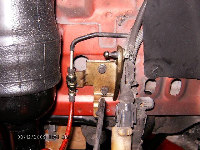

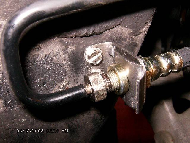

BTW, When you talk to Don Roy about the brake lines, he'll probably tell you that there are 5 brake lines, but ignore that, there are only 4. :) You'll have to figure out a way to secure the lines to the body when you install them, as no bracketry is included. The picture shows what I did in the rear using SS brackets I bought from Totally Stainless.
In the front, the stock line needs to be seperated from the airbag sensor bracket by grinding it off, and then you can just use cable ties to secure the new line to the brakcet.
