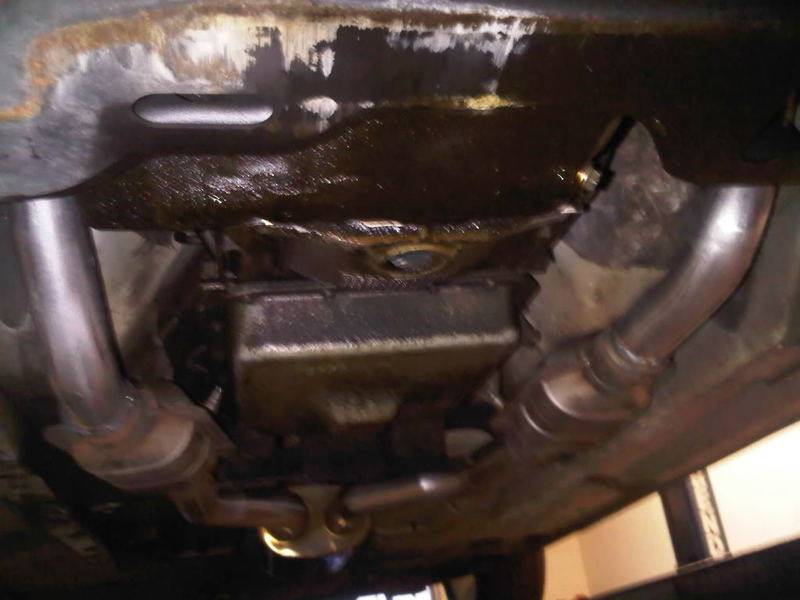

while you might be happy, I dont think your Kmember is loving the lowered coil springs too much..lol
What do you keep dragging your K member on?
That cant be making a cool sound..
actually I have not hit a single bump since i lowered it, This was damage done from the previous owner for driving it with all the air bags on the floor. This is my second mark I have owned and I have never hit anything with them lowered.

You can see "old" and "new" damage..rusty old stuff might be front when the air ride died, but those new shiny scratches aren't from a year ago.
your right those shiny new scratches are new, they were from putting the on the Tow trailer that took me 2hrs because of the air ride being shot when I bought. I towed the car from Southern Cali to Southern Nevada. But for only paying 1k for the car I wasn't complaining specially since I have only dropped around 1200 more to get it to were is at now. I already have the tokico shocks that I bought from laser just have not had time to install them I usually work around 60 to 70 hrs a week and go to school part time and with 2 kids and a Wife time is a precious commodity.

how is that kmember so scratched up and that exhaust is unscathed!? I suggest if you live in the NE with a lowered car raising it up because your exhaust is going to get shredded.
The old exhaust was scratched and bent the new exhaust just got installed on thursday. I live in las vegas and only drive the car 10 miles a day and I alternate between this and my sports bike.
