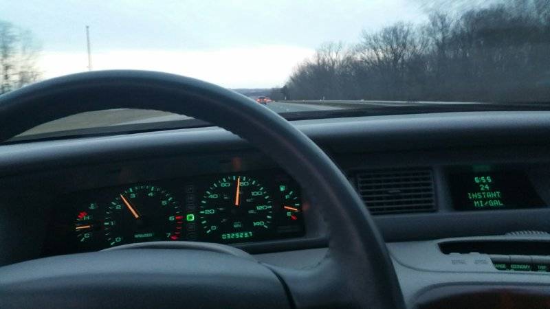

        how much faster (in seconds 1/4 mile) would each of these make a 2nd gen M8?

        I did 3.73s in mine and while they are great for the highway (I have taken it out of state and halfway across the US) if I had to do it all over again I’d go 4.10s

        I wouldn't think there would be a big difference in rpm at 70mph between these two gears. Do you recall at what rpm you were at 70mph with the 373's?

        I want to say:
        2400@70
        2500@75

        B07D02C2-C826-43FD-9476-00B553D2C6BD.jpeg Found this from earlier this year with the 3.73s installed
