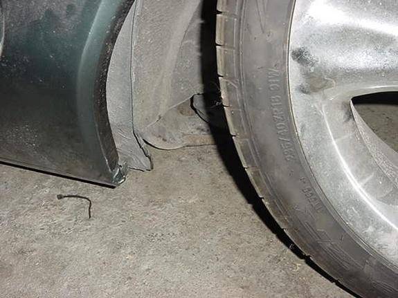

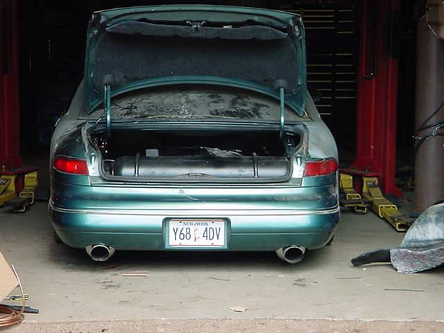

On my old car the AssassinVIIIor, I had fast bags as well (like 4 years ago) and what was done to get the front down is to remove the inner bump stop that is in every front bag assembly. I had 2 N2 tanks in the trunk with 2 compressors as well, and ALL copper hardlines, no plastic to deal with. Here are a few pix of what it looked like with the bump stops removed and rollin on the 18's.......

I need to get the bumpstops out too! Any chance I can get an explination as to how to get them out?? I'd love to lay frame!

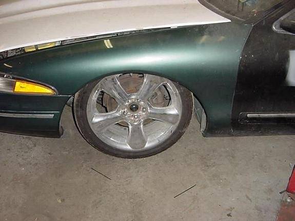

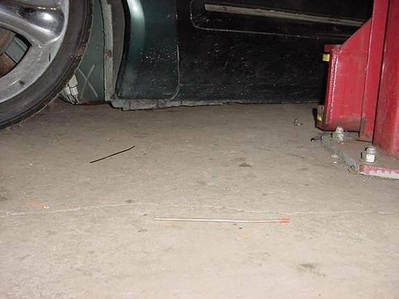

Now, the biggest problem is that if you have the factory exhaust on the car you will never lay it all the way down. My car sat up a bit due to the fact that the cat's up front hit the ground before the frame/body of the car did. But after I went with headers it layed out in the front. As for the back the rear body mount sat on the ground, and from what I could see I still had atleast 2 more inches of drop cause we drove the car up on 2X4's and released the air out of the bags and with the car on the 2X4's it still layed frame (as much as possible). You can see in the pix I attached what I mean as far as the front being still a bit higher than the rear, and that the rear body mount sat on the ground.

As for the removal of the inner front bump stops, you have to open up the airbag and physically remove the bump stop from inside the airbag, then have someone with a crimping machine big enuf to crimp the band back on that you have to remove to get inside the bag itself. Not an easy task if you do not have the necessary tools.
