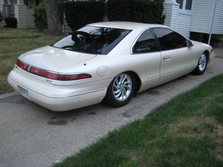

I'm like you, the slow rise/lower is sweet!!! A few little things I gotta let you know about before you go down the road in your hot Mark! The wheels are going the wrong direction...(sorry) and the trunk adjusters need cranked out a little your lid is sinkin...Im sure you were plannin on straighten these things up before you hit the road to show the world that a Mark VIII is the 5hit!

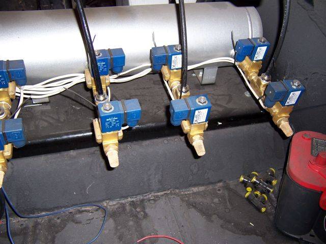

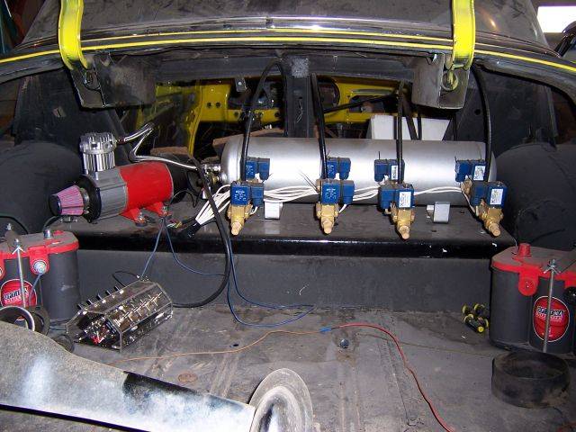

The install took about 12 hours total. TOTAL price for aftermarket air is about $500...give or take, depending on what components you choose to purchase. I have used this site: http://suicidedoors.com/ for years now, and IMO they are THE BEST guys to buy air setups from. Pricing is the best too! You'll need a tank, compressor, a relay, 8 valves, tons of fittings, airline, wire, and a switchbox of some sort. ALL of the things you need are available on that site! Check it out, it's sweet!
I am aware some of the body lines are not straight yet. I have lots of adjusting to do still. I like the wheels in that direction, I actually turned them so that they were backwards, just so it looks different! :) Do you like them that way?

Yeah figured as much with the wheels ;) lol , smacking it or biting it, just not both on the same side!!!

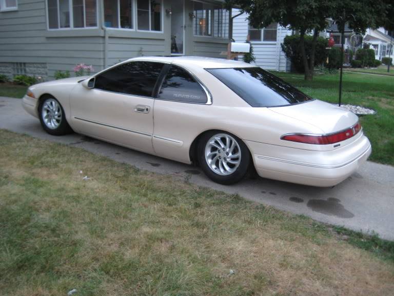

Here's a few pics of it laid out in the driveway at home... The front grille is misiing, so until I get one, I won't post a pic of the front, lol...
haha, so i went to matt's (pimp) to get my windows tinted, and to my surprise i hear a lot of air as we r both parking, i look back and its slammed :eek: , its so nice, my car looked huge compared to his, thanks for doin the tint man, and where r the videos? cya saturday
*edit* after he tinted my windows we went for ride in each others cars, that "fast" bag setup is so fun, i want one

I have had fast bagged vehicles in the past. I have had both setups, ones with all the valves right off the tank, and valves near the bags. My theory is this, with the valves close to the bag, even though they are subject to weather (they are designed to be anyways) the tubing acts as extra air volume to store. There is also less volume to fill when I want to fill a bag, essentially more storage, and less waste. This decreases my compressor duty cycle as well. (It has a 100% duty cycle, but why run it 100% if I don't have to?) Cost was not the issue with this setup, I didn't mind using extra fittings.

I didn't keep close enough tabs on exactly how much I spent, but I'm pretty sure it was close to a grand, after all was said n done. I just got all my gauges, which I didn't have when I did the setup, but I have everything ready for the gauges, all I have to do is run the lines to the valves, n I'm done. I coulda just slapped a new compressor & relay in, but I like doin stuff different...lol. I just installed the Sirius Satellite Radio Sportster 4 in the cockpit, and wired it directly into my aftermarket radio. LOVE IT!!!!!
