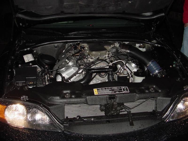

      So the 4.6 could've fit. Wonder why it never went any further than this. Also amazed this still exists and never made it to the scrapper.

      This is a very old pic.. It fit, but looks like they had to make alot of compromises, especially to the intake.

      Very tight fit. Probably could never be installed from underneath making it impossible for production. Sure hope it's still around.

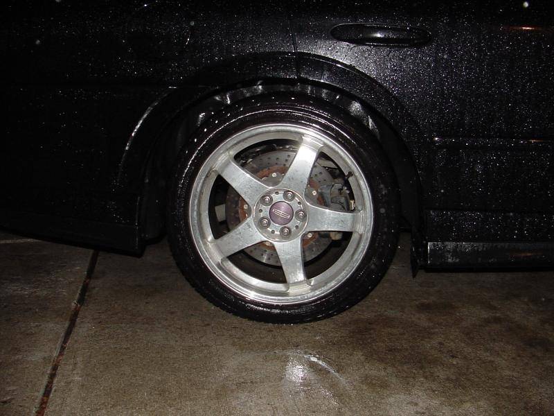

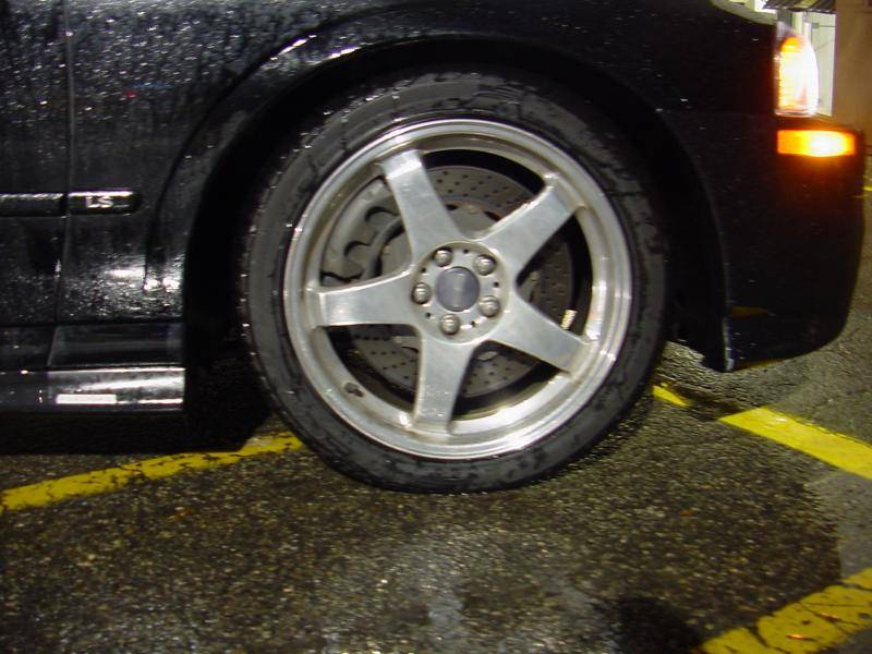

      Looks like stock calipers, just larger rotors.

      Thats what I thought too.. I'd love to get my hands on that design. I don't really need more caliper, but I'd sure love to have larger rotors.

      looks like a 2nd gen mark viii motor.
      it has COPs and cable operated IMRCs with a custom intake. which makes sense because the 2nd gen intake was kinda tall.
      those brakes look great. same idea as my rear brakes. i just moved the caliper farther out and adjust for the offset for the new rotor with spacers and some plate steel. fairly simple process.
      also, the 4.6 has been installed numerous times into an LS, both the DOHC and SOHC varieties.
      i've always heard that Ford wanted to use the 4.6 in the LS, but its too wide to load from the bottom. this lends some legitimacy to those ideas.

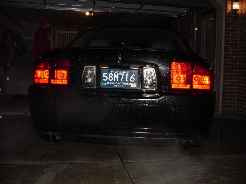

      Not a factory car at all. Manufacturer plates does not indicate a factory built car.
      Yes, the engine will fit. It just won't fit from the bottom; which is required on the assembly line. The One Lap of America LS had a blown 4.6L installed. Besides the electrical problems, they spent the whole event trying to keep the engine from overheating.
      The calipers look stock; just drilled rotors.

      I pmd the guy that took the pics. I think you are wrong and I believe it's a factory car. Look at the intake. No one else is going to go thru that sort of trouble to fit the intake under the hood, among other things I see in the engine compartment to make me believe its factory. Pics were also taken in Michigan

      There doesn't appear to be anything special about that intake, looks like one big rubber tube actually. Any hope of claiming this as factory was ruined by the completely unmatching shift knob.

      You're wrong. I was also talking about the intake MANIFOLD.. not the inlet tube.. Back in 2001, there were NO aftermarket intakes for a 4.6.. The intake manifold on that car is one of a kind, and I guarantee you some little shop didn't make it and it's not someone's toy...
