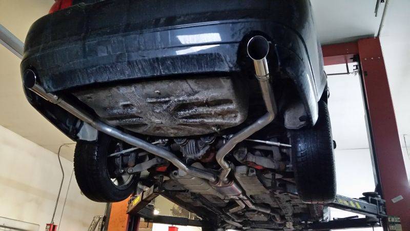

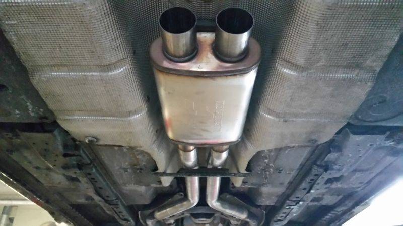

If someone would pull up my post from the what you do today thread for pics. (I'm on the road with the tinny tablet buttons)
page 193
http://www.lincolnvscadillac.com/fo...-today&p=2037398938&viewfull=1#post2037398938
1 single Magnaflow # 11386 - 4" x 9" x 14" Dual In/Out Satin Stainless 2.5" True X core design,
positioned in the tunnel, third CAT and resonators deleted, 2.5" piping w/ chrome Magnaflow tips.

Bigrig - quick question - why did you decide to place your muffler where you did? Clearance? Sound? Science? etc. Just curious. And I forgot to take measurements when I was under mine.

It's simply the most widest part in the tunnel and the heat shielding is optimum in that spot. Other then that, it's because it replaced the resonators and third cat, also looks coolest in that spot and gives a good overall deep throaty sound like you'd expect from a mid cross muffler.
that is where it fits best (all together its not really that much larger than both of the OEM resonators).
my biggest two rerasons for putting the muffler there (soon) is that A: by putting it there instead of in the back OEM muffler location, I was able to buy one $100+ muffler instead of having to buy two $100+ mufflers. and B: from many other cars that Ive heard, I think there is a little better sound when the muffler is in the middle of the car VS at the back... so its a win win!
