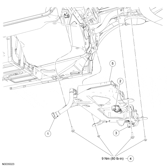

    Anyone know the location of the Evap canisters and vent solenoid on a 2000 LS?

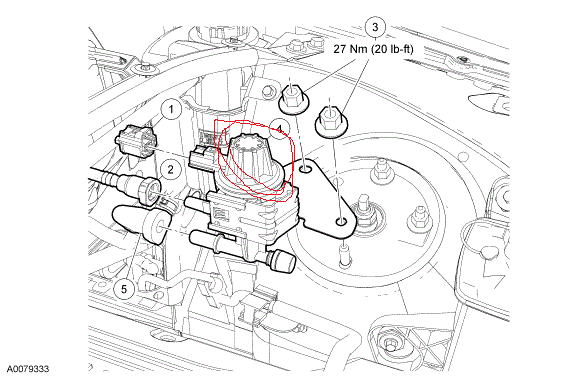

    It's mounted above the rear subframe. You have to take the subframe off to get to it. Both the canister and the vent valve are there. The purge valve is under the hood on the driver's side shock tower.

      Incidentally Joe, that knob on top of the "purge valve" it turns.
      What if someone turned that not knowing what it would result.
      I grabbed a hold of it one day and ended up turning it both ways a bit.
      Any ideas?

      I think that's just a dust cap that is snapped on (but I really haven't looked into it).

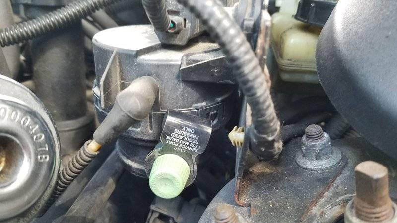

      This? Just a dust cap

      No, that's a cover for a test port.
      I thought he was talking about the part circled in red below. (He did say "top" and not the side.) Perhaps he can confirm...

      Yes 4, wasn't sure if it was supposed to move. Hadn't noticed before.
