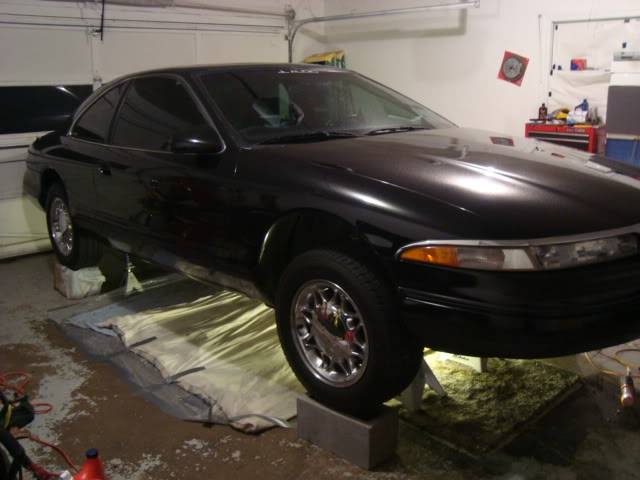

Now if I could be like DLF and 94m5 and have a lift out there, that would be wonderful. When I swapped transmissions out in the 94 over to a 98 trans, I had to go about it this way. Plenty of room to do what I was doing.

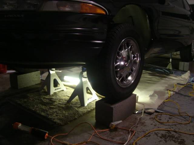

Two 2 ton jack stands in the rear, two 4 ton stands up front and all 4 tires were up on cinder blocks. :D I fear freak accidents and hate being under a car and I won't get under one, unless I am the one that has gotten it up there and made sure it's stabilized.
