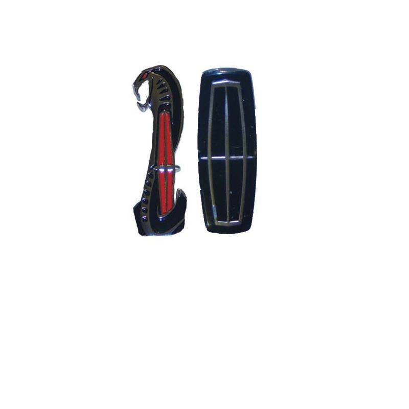

Nice. Yeah a few years back I made clear corners, tinted corners, gen1 headlight reflectors clear and tinted, gen2 headlight reflectors clear and tinted. I had some gen2 side skirts without end caps so I borrowed some and made a mold out of them, thats how I got into this mold making replication stuff. Have a lot of other ideas but other projects have kept me busy.
Oh, so you were the one supplying all of those! AWESOME! Any reason you didn't make a full LSE kit? Mind you, I have no idea what that would cost to make or what materials would be best. Sounds like you are very knowledgeable and I would love to be able to reach out if I'm having any issues.

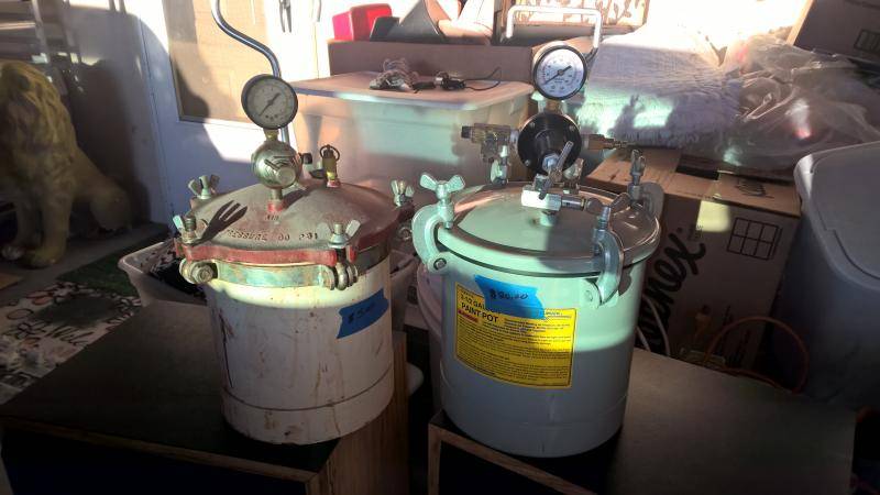

Pressure pots picked up today for $25! The one is brand new.
Yeah that was me, great learning experience. Well before I did something that big I wanted to get more experience, an emblem or clear corner mold isn't too expensive if you mess it up but messing up a side skirt mold would hurt my wallet. Also, I think for big parts like that it would be better to vacuum form them, make them out of fiberglass, carbon fiber etc, but one can always try using these pour in resin method, use abs type resin or even get creating amd line the mold with fiberglass or other fillers for extra strength
Nice find, I have one of those little ones but as you start getting more ideas, you quickly run out of room.

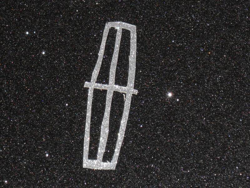

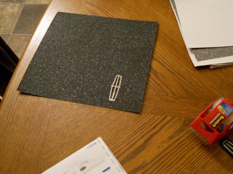

I was getting ready to make my emblem with CAD and a laser cutter. At the time, I was just going to make it a flat emblem and a single layer of etching (probably multiple passes for depth, though) to make my emblem. For whatever reason, the cutter would not pick up what to etch, so I just cut a blank oval from plexiglas and went home. Before I had a chance/motivation to try again, I had transferred schools. Apparently it is NOT normal for schools to just leave their shop doors open all day... Everyone else has strict class-requirement restrictions on shop use. While I understand these machines are expensive (laser cutter, 2D water jet, massive 3D CNC, lathes, mills, bomb-proof work tables), having that creative freedom for our own projects made it much easier to learn how to use the tools, if we were interested (I was).

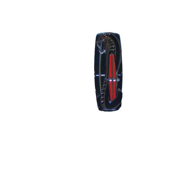

I'm not going to quote all of that just for the sake of space but I gotcha. I've always wanted to join TechShop just for access to those kinds of tools. I did plan on making a mold of an emblem blank with no recessed Lincoln star so I could add my own items, be they 2D or 3D. So if I sent you a blank you could probably etch it with a laser cutter or small CNC to get your 3D look. I do not know how it would look once painted but it'd be a start. Maybe a side venture there where I produce blanks and you can mill/etch out people's designs for a fee.
My original idea for the blanks was so that I could pour the front half of the emblem, lay down a 2D design and then finish the emblem so the design would be floating inside.
