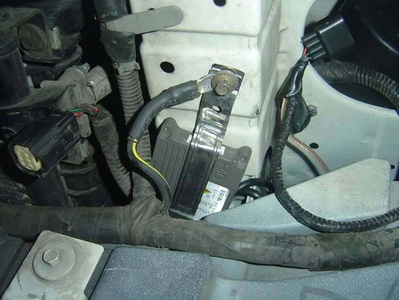

I did ground a wire for the realay that got me thinking it was making bad contact. I just cut it off but last night I actually took the screw off and the wire out completly. I was trying to find what it was ground for in the wiring diagram, but then again I'mkinda lost when lookind at tha book :confused:.
It the ground that is directly behind the left passenger headlight.
This one. It was on really tight but who knows, maybe it was the cause

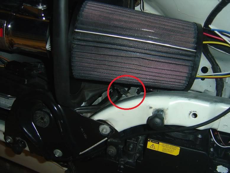

Problem solved I think, I hope. Do there was one wire that I forgot I touched. It's in between the filter and the headlight. I was going to mount the relay there but found a better location. I only unscrewed it a little and left it when I found the other location. Good thing remembered. I took the ground wire off completly, locked the car and pressed the "close hood" button, and guess what, the radio turned on and wheel went crazy. Screwed it back on tight and it didn't happen again so far.
Well now i really feel like a genuos, yes I know it's speeled wrong but I feel like a genius
:slam
This is the ground that was loose. I dont get how this being disconected turned those things on.Oh well, atleast it's fixed. Now I feel like re-doing all my angel eye/puddle light relay wiring. :mad:
