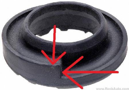

If you have both front springs installed on the front, and both rear springs installed on the rear... check to see if your sway bar links are intact.
Otherwise I would question the spring/strut mount coil seat... maybe one or more are degradded/crushed/falling apart.
Isn't there a correct position for the spring/coil installment... like the end of the coil has to be positioned correctly against the "upper" strut mount coil seat?
