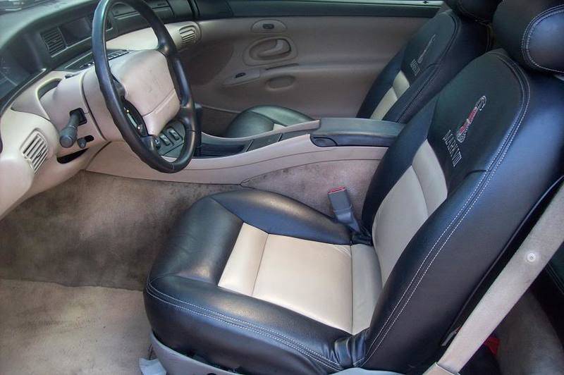

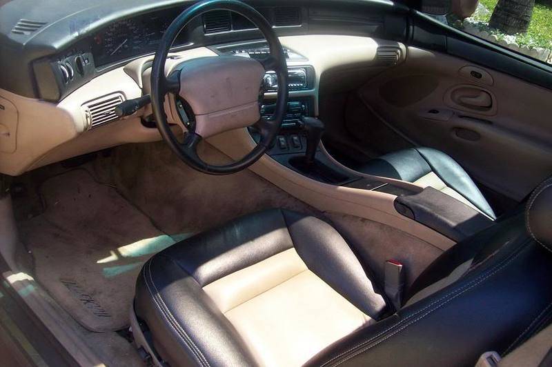

Ok, so here's the deal... I've shampooed my carpet twice & it simply doesn't improve. My interior is disgusting, I'm tired of it. The nice new seats don't match the rest of my beat down carpet & steering wheel. (The retard that owned it spilled god knows how much crap on it & tore the steering wheel apart) & frankly I'm tired of the tan carpet, I want black carpet in the car. The ideal thing would be to purchase a new rug but for those that don't know I'm unemployed & every dime I have is extremely important to me. I want to dye my carpet black. A friend of mine did it on an Acura Integra he used to own about 6 years ago & I remember it looked like new but he didn't keep the car long enough for me to know if it was worth it. I have my truck to drive so I can take the carpet out of the car & work on it outside!
I've also heard that there are people that wash the carpet, use spray paint then wash it again. Being that the color Im going for is black I figure imperfections will be hard to spot.

Number 1, I dont believe in aftermarket carpet anymore. I payed 400 bux for one for my SHO a few years back it was "molded"...ya my butt. They just put some half ass dips in it for the floor pans. It was awful. I could only imagine an aftermarket carpet for a Mark with all of its angles and contours. I dyed one of my old carpets gray, but the carpet was already gray. It looked great, but if always felt kinda crusty if you touched it. Kinda like if you let pop dry on the carpet.
Ive done it to my tan carpet and it WILL wear off showing the tan under it. DONT DO IT!! you will regret it everytime you get in your car. Just hold out for someone to post a half way decent carpet.

I take apart the car & when I pull out the carpet it freakin looks charcoal gray. I had already paid tha man so the hell with that. I washed the carpet when I brought it home but I can't get over how gray it looks. I didn't want to go through this dying situation but I guess I'll have to anyway. Anyone have any pointers?
I used a fabric dye spray that was supposed to be for car interiors on the carpet in my Merc a while ago. I went from very light gray to black, but it never did look black anyways, just dark gray/charcol. It did last for many years though and only got a hair lighter...
