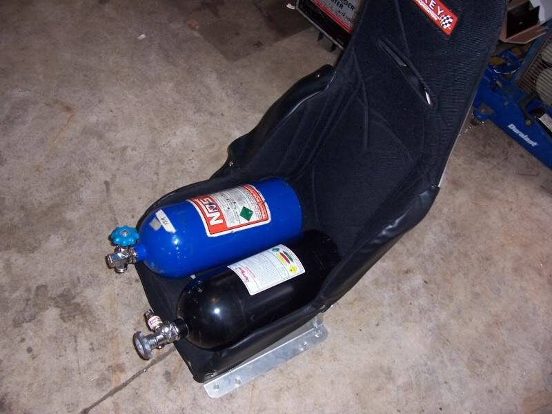

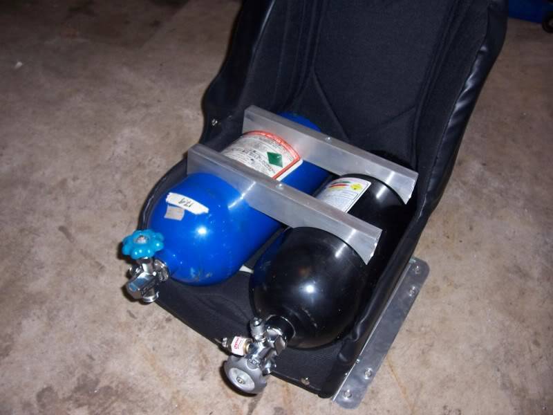

My buddy with an 8 sec 68 Chevelle(all steel.all glass stock susp on 10 inch tires thats the gratuitis name drop right there:D) Dropped of this to make for him. He had heavy steel dual mount that was hard to mount and work with.

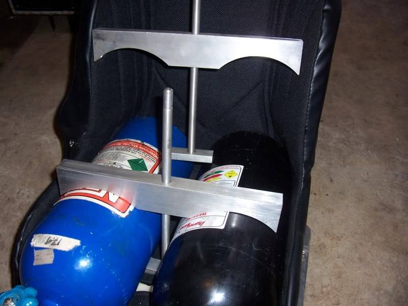

Found some nice light alum box tubing to make 2 hold downs out of. Here they are to start.

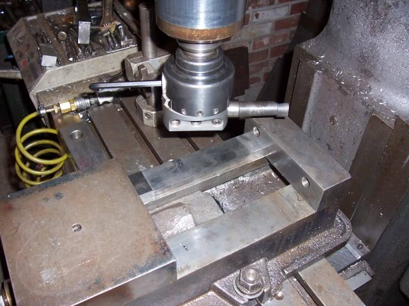

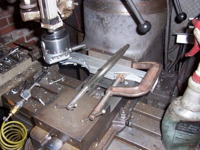

Here setting up boring head to samew dia as the bottles to make cut outs in bars.

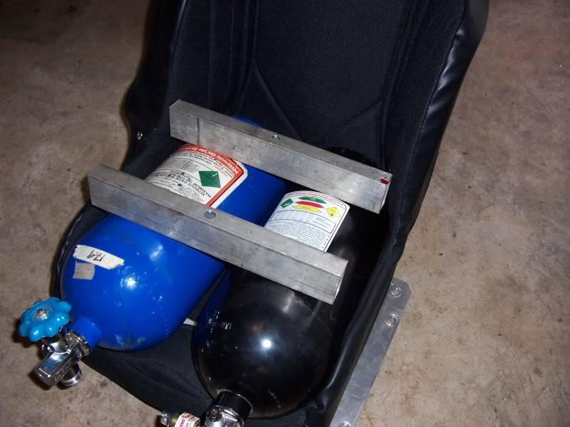

Here is cutting in scarfs and the finished bars on tanks.

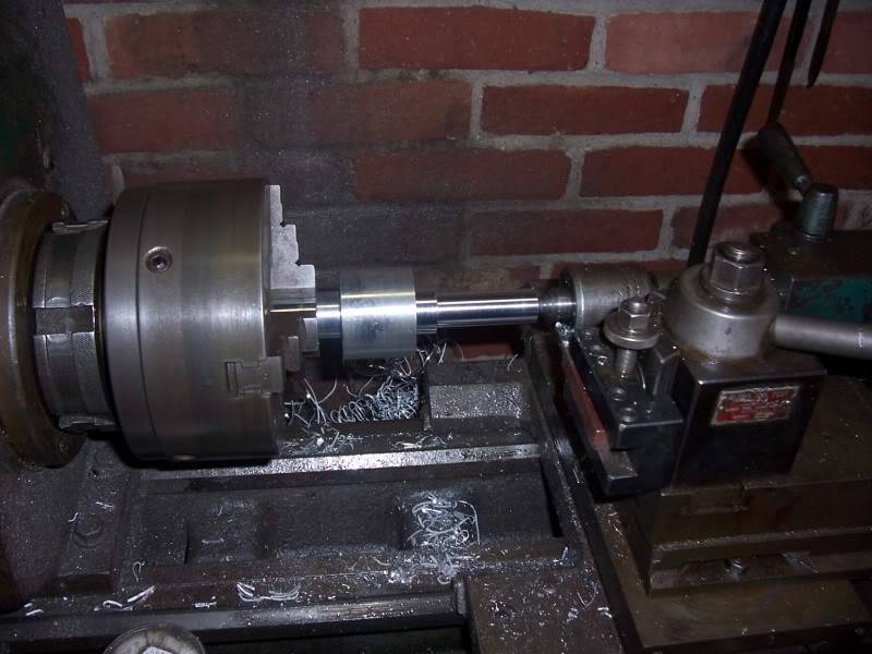

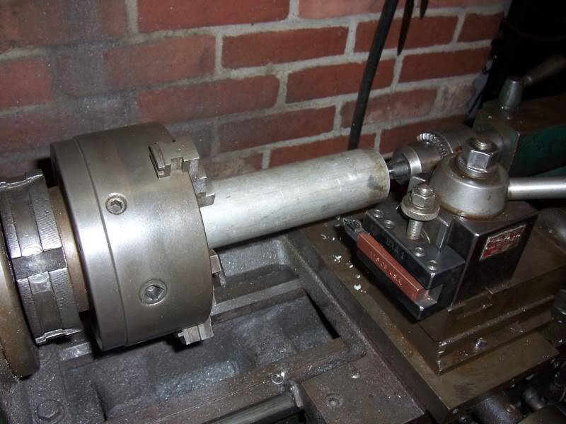

Next made are the 1/2 alum studs and thread nuts Here they are. These will be welded under seat.

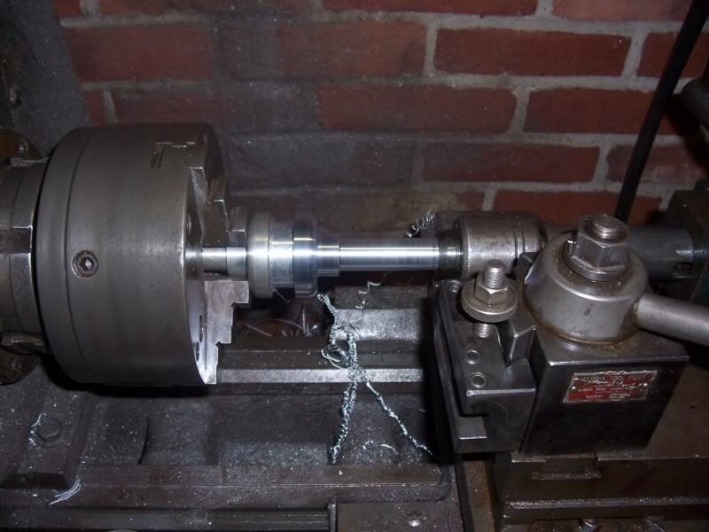

Next up are the knobs. Here are raw,rough and finish shots.
There are drilled and tapped 1/2-13, countersunk and counterbored to slide on to the 1/2 alum studs super easy.

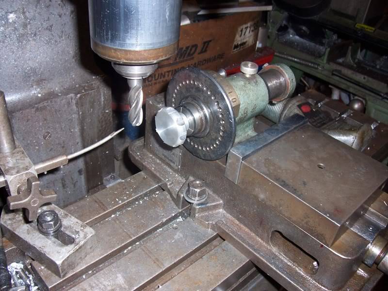

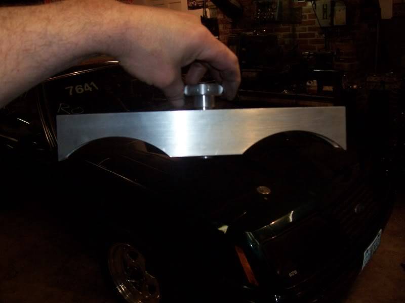

Here is maching on the notches to make the grip.

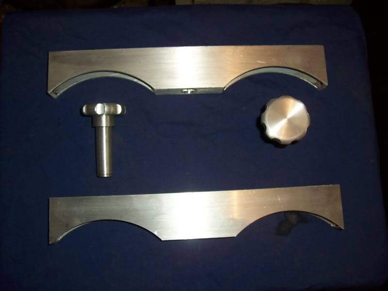

Heres all done, The knobs are made to lock into the bars so not 4 peices on the floor only 2 bars.

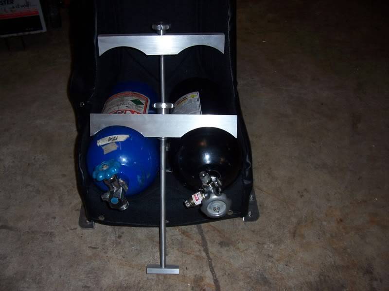

This shows the knobs locked on.
Heres everything laid out. Nice and super light and strong. The studs will have hexes machined onto them so he can install and take out fast to let wife get in seat. All this was done pro bono.
