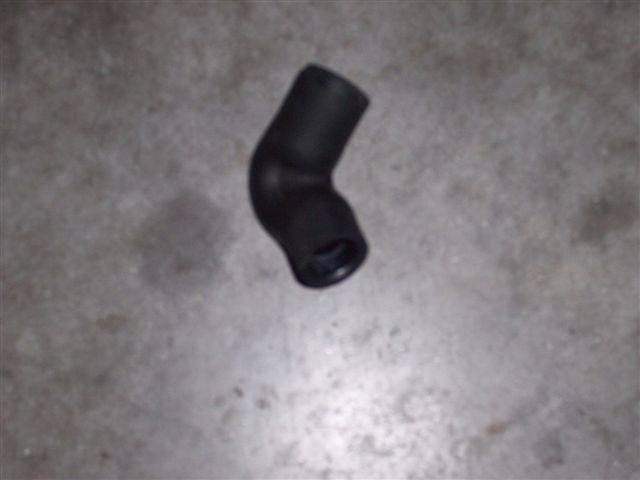

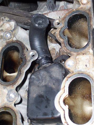

seems we both got an education at the same time and in the same city. I suspected it was that PCV but did want to believe it becasue I was in the near that piece 4 weeks ago but had to close up everything becasue it was getting late.
I could kick myself for not going long on that play. Damn I hate rework. My PCV elbow tube was completely collapsed; was yours. How many miles are on your LS? No worries on the help thing I need that merit badge any way. Do you think you can make the event? For 25 bux it gets you and a guest in and your car photographed with the P51 Mustangs. Sounds like you have everything repaired on your car that you could ever want but if you need a second or third set of hands let me know.

Yea, mine was collapsed, my LS has about 51k on it now.
I have to work saturday mornings but could make it later on. Sunday would be a definate date i could make in the morning.
51k less than half of what I have. I am now at 109k miles. I think it might have been on its way out for a while though judging by the looks of it.
some pics
