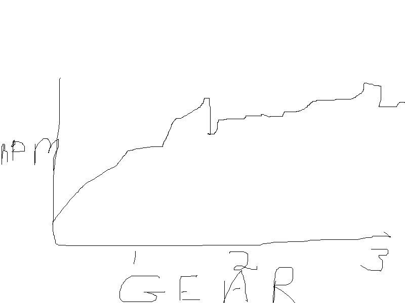

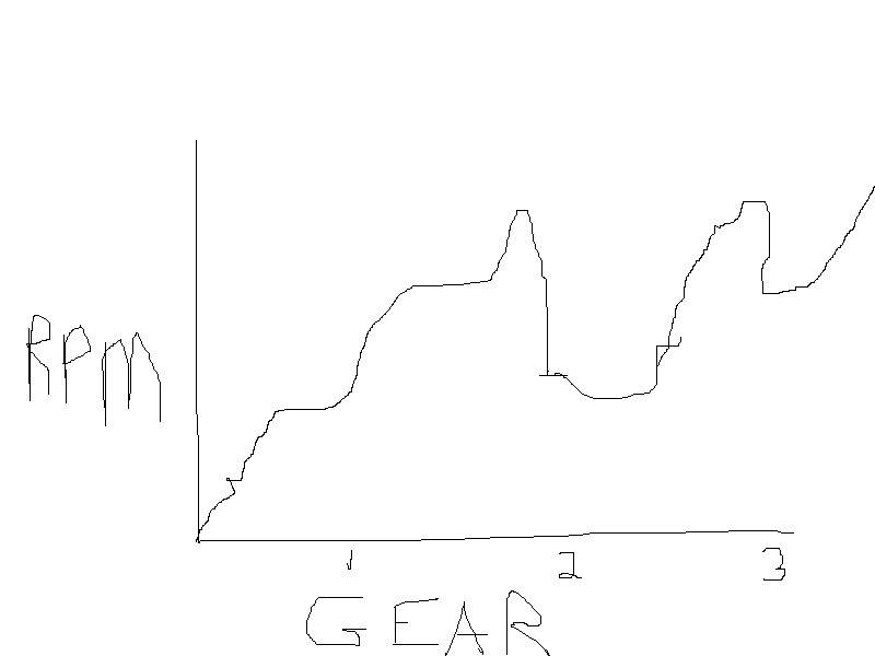

A high stall will keep the car in its powerband. At WOT, my car shifts into second gear and "falls back" to about 5000 rpms. Compare that to a stock Mark VIII that falls back to about 4000rpms and has almost 1000 rpms more to pick up before it is in the best part of the powerband.
You'll appreciate this. :p
Stock Converter:
High Stall Converter:
What an awesome set of posts and drawings. That does clear things up quite a bit. Thanks kirk
