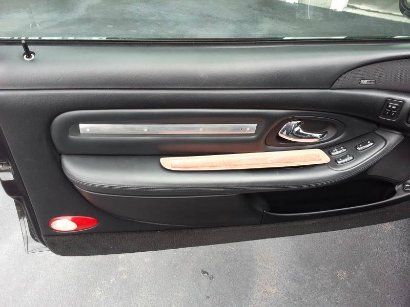

my 97 mark viii door molding fell off on me... i was just wondering if someone on here had a similar issue and wondering there experience fixing it. i think i might use some hot glue, or maybe i will disassemble the panel and remove the metal piece and use some 2 part epoxy. not really sure. If i remove the door panel, does the metal piece even come off the door panel or is it built into the panel itself?? thanks for any input. Dave

Don't have any experience with 2nd gen door panels so I'm not sure what metal piece you mean but I'm working on a set of door panels for my car and I've bad to reglue some areas that were starting to seperate and I used loctite plastic epoxy (2 part) which has worked fine. Loctite makes a few kinds of epoxy for different materials, I bought it from home depot.
The fake wood trim has two small studs about an inch long. They are held on with these little locking washers. It goes onto the vinyl part of the door panel. The vinyl part has these plastic studs that hold it on with little 10mm nuts. They are not real nuts though. They can be removed by hand.
What most likely happened is the studs broke off it the locking washers came off.
Glue it..or find another 2nd gen door panel and grab the trim off of it.
i just hope the metal piece comes off easily so i can correctly glue it back on and remount it correctly.. gluing it on i know is easy, just not sure if that metal piece comes off easily. I dont want to glue it on in place because i dont want it to be loose...

I don't think you're gonna get a good glue joint unless you disassemble the door panels and re-glue the metal bracket back onto the trim piece.

The metal "bracket" is held on by those spring steel push nuts like this. Getting the center panel off is fairly easy, as you can twist the nuts off, as long as you do it very gently. The nylon studs will be brittle and can break easily. The metal bracket is a pain though. I ended up having to cut the nuts off with sheet metal sheers after prying them up slightly.

For your door panel trim, if you remove the whole door panel, flip it around and like someone else mentioned there should be a few studs that poke through to the back held on by small sheetmetal nuts..(if it's at all like gen 1 door panels) use a pair of needle nose pliers to remove the nuts (you will understand why when you see them, they are flipped around backwards and you can't put a socket on them..the hex part faces the wrong way). Once you get those off the wood grain piece should just pop off and then you should be able to reglue it easier, so you don't get excess glue on the front of your door panel.
thanks for the info! thanks for the pics Marcus! Atleast i know i should be able to get the metal mount off easy enough. Now I Just gotta look into the right epoxy for wood to metal.

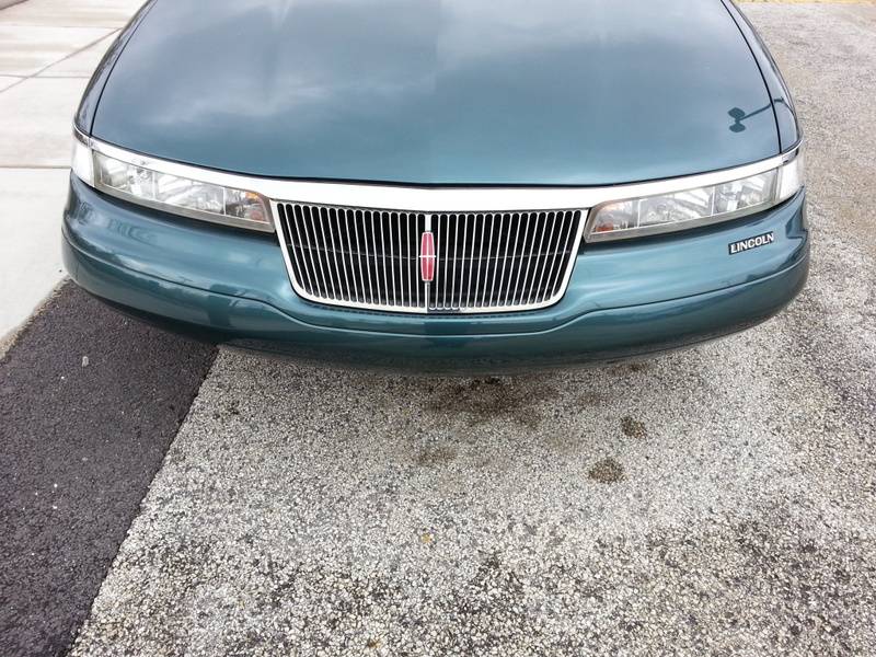

I mean the chrome trim at the edge of the hood above the grille on a 1st gen
(Runs the full length of the hood) here's a pic of mine..the chrome is starting to fade on mine.
no i am sorry, the trim is totally unavaiable. the part number is F3LY 8419-B
for some reason there are 42 first gen Left hand headlights still available... odd..
Damn..guess its back to junkyard hunting.
