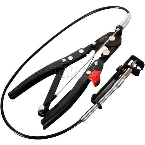

The hardest part is the spring clamps on the heater hoses going into and out of the heater core. The prongs that you need to squeeze to loosen them are pointed downward, and very hard to get to. I use a set of 45-degree 12"-long needle nose pliers, but it still sucks.
This is your friend....
Holy crap, that looks amazing!
Does the head of it articulate at all? Hard to tell from the picture. What's it called? Have you used one before?
Flexible Hose Clamp Pliers.
I have used them before but for some unknown reason in the universe, I do not own one.
You will spend about $35 on a decent one on amazon or sears might have one as well. Anyone who attempts a thermostat on a Mark VIII would benefit from this.
