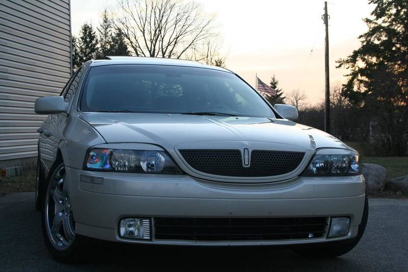

Detailed my car again.
pektel
Jun 15, 2007
10,905
53
up nort
Well, the exterior anyways. Wet sanded most areas (not all, as I didn't have the time) then polished.
Products used:
wash:
Chemical Guy's Citrus Wash and Gloss (at wax stripping concentration)
CG sticky wheel gel
Swissvax wheel brush
Uber wash sponge
Clayed with Bilt Hamber soft clay, water as lube
Sanding:
3M imperial wet dry - 1500 and 2000 grit wet sand.
EDIT: sandpaper was soaked in water for 24 hours before sanding. I also used a 1L spray bottle filled with distilled water and a couple drops of car wash for lubrication.
Polishing:
Makita 9227C rotary
selection of wool and foam pads
1Z proline Pasta Intensiv
1Z proline Hoch Glanz Polish
LSP:
dodo Juice Lime Prime Lite
Dodo Juice Supernatural
Wheels also received Poorboy's Wheel sealant.
Tires/black trim/engine plastics were dressed with Surf City Beyond Black Tire pro.
Only have a few pictures, as I just finished a little bit ago. More pictures tomorrow after the second coat of wax :D

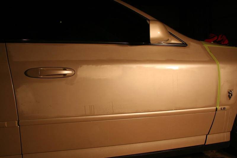

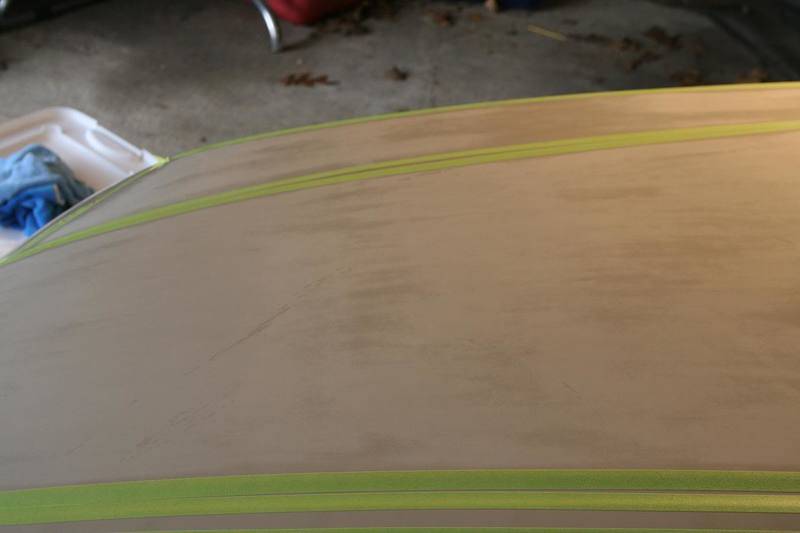

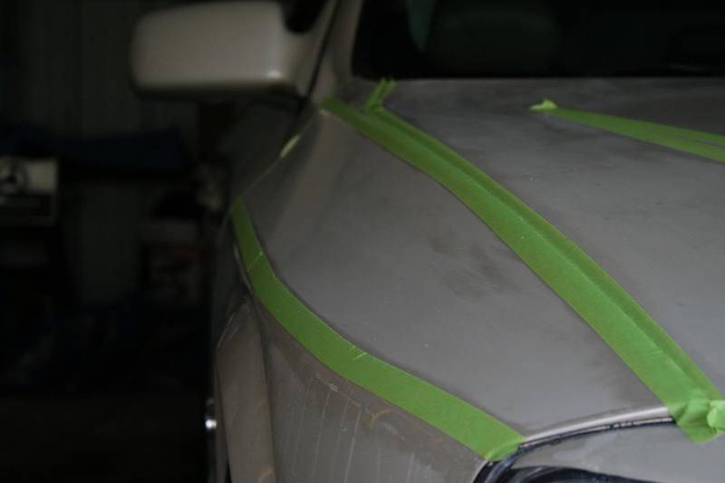

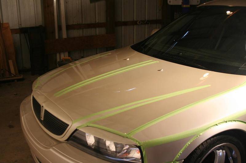

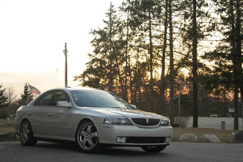

prepping for sanding. I went through 2 full rolls of tape :eek:

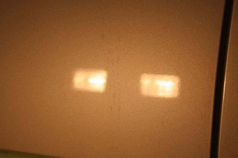

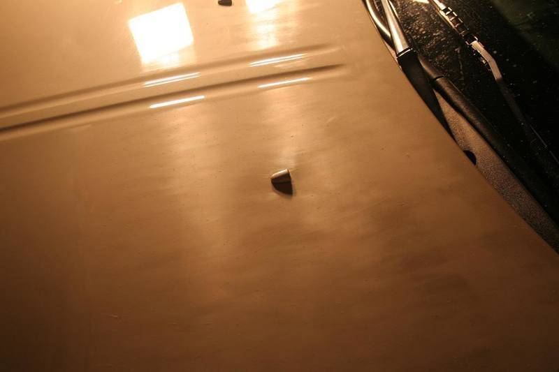

Gave me this after wool pad x 2 passes

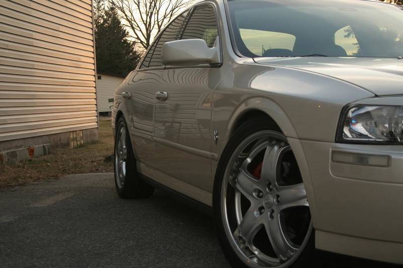

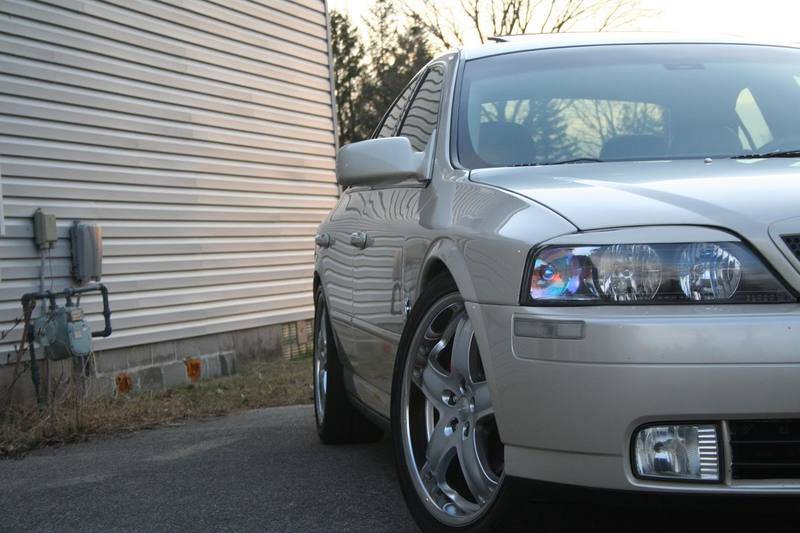

after:

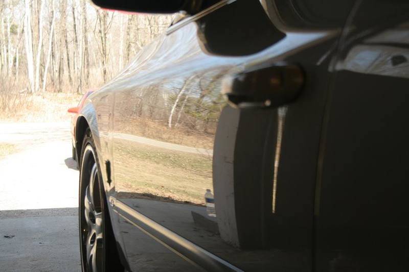

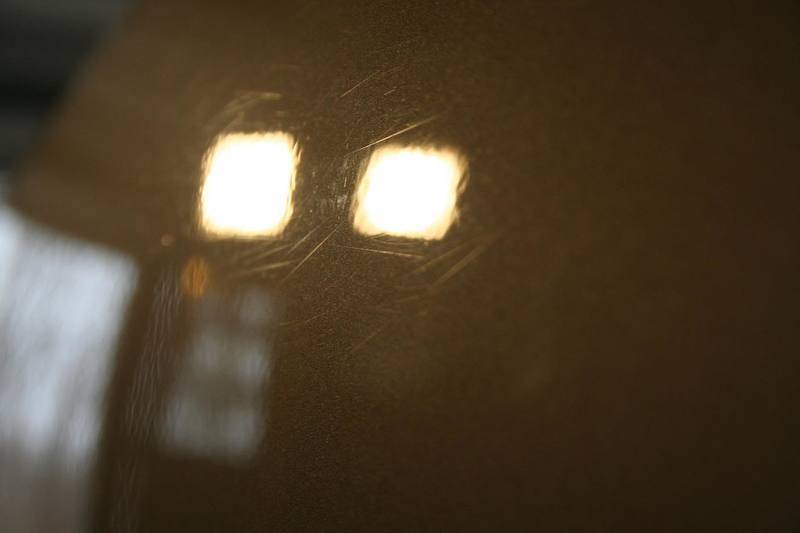

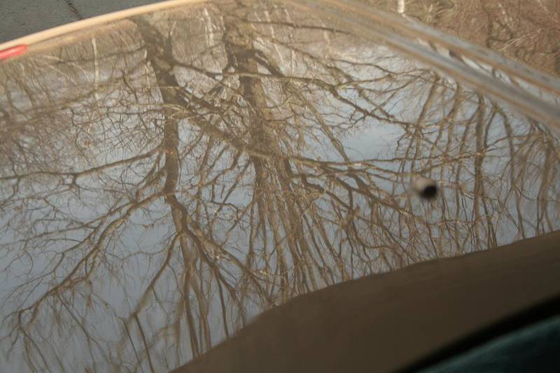

Came out pretty good. I like the reflection pics. You should post some previoud reflection shot and the new ones to show how the orange peel hides so much! How bad was she? Did you end up with lots of those poka dots? Glad it came out pretty good for ya! I love the results of mine!

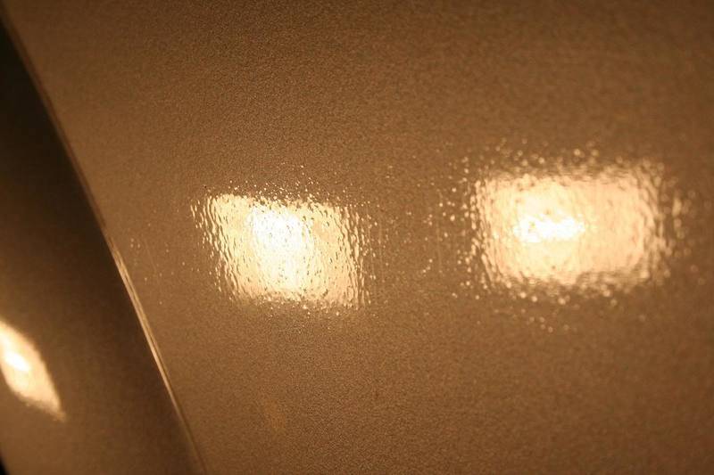

Okay, here's some more. I included some orange peel pics for sully :D
Before:
Here was the worst spot, on the bumper right behind the driver rear wheel:
driver's door:

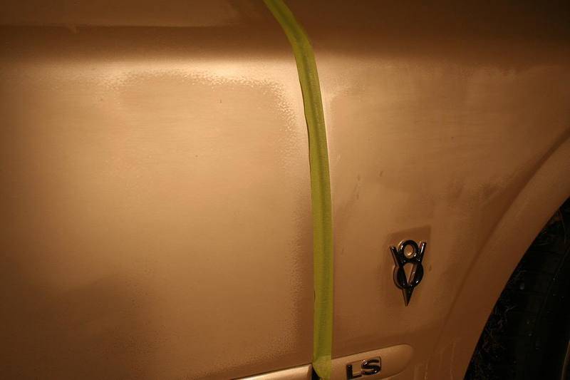

During wetsanding. you can see how bad the peel was in some spots. at the edges of the sanding areas you can see the polka dots from the high spots of the peel being sanded away:

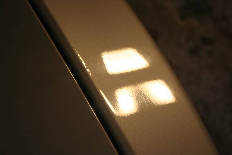

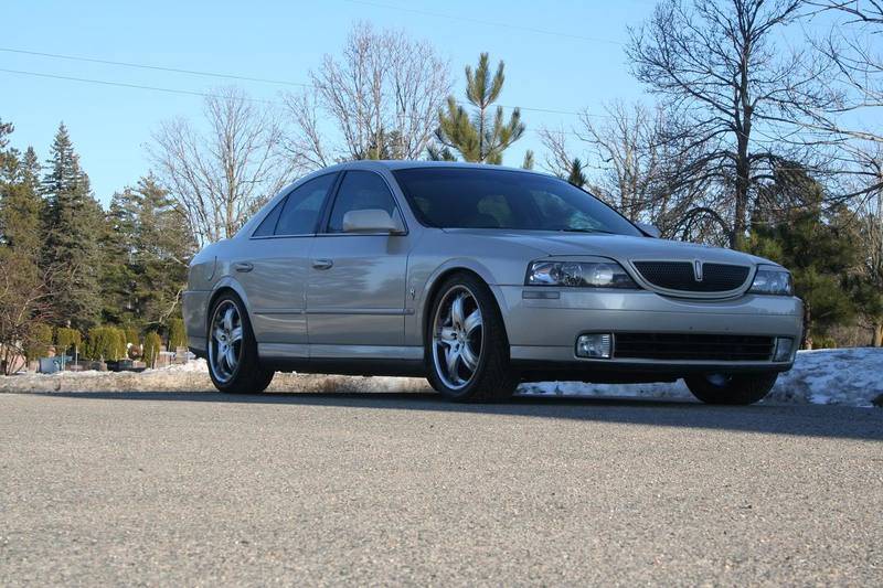

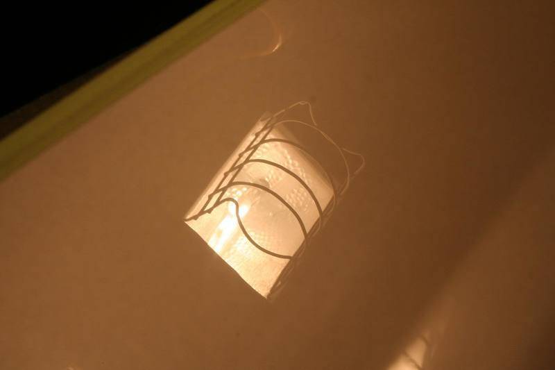

Some afters again. It's really tough to capture reflections on a light colored car. It looks so much better in person. In the shot with the flood light, you can't really see it in the picture, but I can read the writing on the reflector inside the halogen housing.
Thanks for looking!

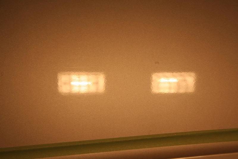

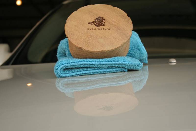

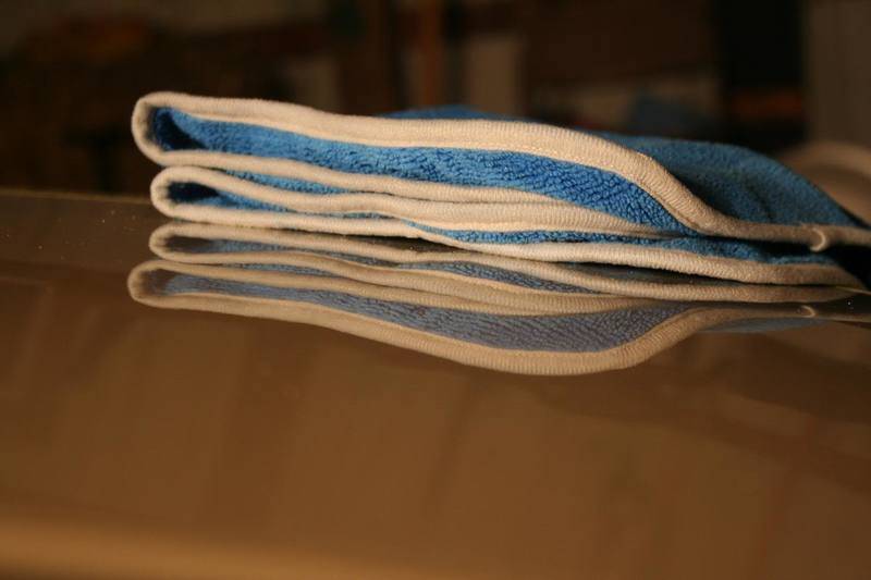

Look at the difference in reflections. Pay special attention to the clarity in the side of the car. Sorry for posting so many pictures, but I'm impressed with the difference in reflections
before:
after:

ok, I dont get it... Why did you wetsand it? dont that hurt the clearcoat? And why did you tape it off? Id LOVE to be able to this this, but I just dont understand what and why, lol!!
Do you proceed to polishing after the wetsand??
Does it hurt the clearcoat? Well, it does remove quite a bit more than the polishing. I stayed pretty tame with 2000 grit. You can still burn through pretty quick with that though if you are not careful. What I've heard is the clearcoat on a car is about the thickness of a piece of office paper (about 3.5 mils)
I taped off all the body lines and peaks, because the clearcoat is normally thinner in those spots. I wanted to make sure there was no way I was going to sand over those.
If you examine your paint closely, you will see it looks bumpy/wavy. That's commonly referred to as orange peel. It's what prevents good reflections on a vehicle. Keep in mind that wet sanding will prevent any aggressive polishing in the future. That's why I only knocked down most of it, and did not remove the orange peel completely.
After that the entire surface was polished with my makita rotary and wool pad with a moderate polish to remove the sanding scratches. Then followed that with a finishing polish/foam finishing pad to remove the hazing and holograms left by the wool pad.
I probably have 30+ hours into this detail. And I could've taken it further than I did. But I need my car tomorrow to pick up the girlfriend at the airport.
