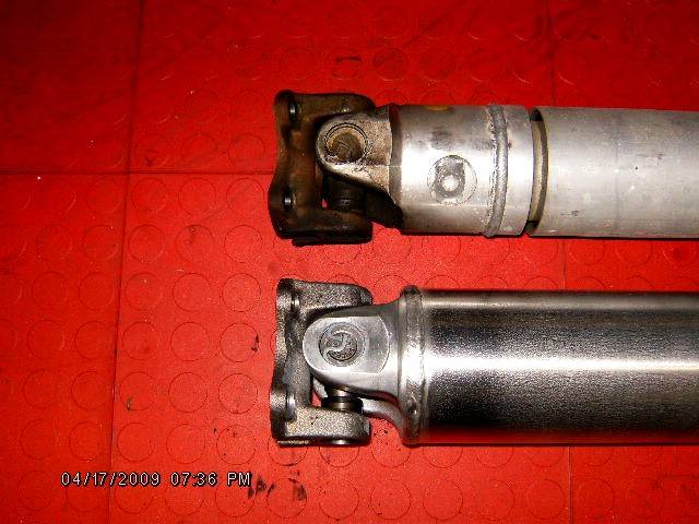

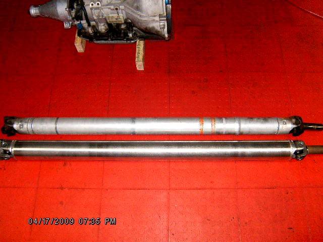

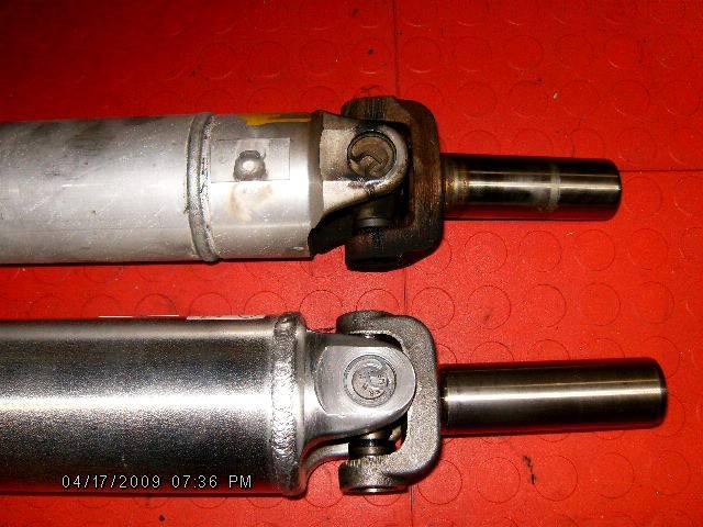

I have an original DynoTech aluminum Metal Matrix Composite 3-1/2" driveshaft. I didn't think the vibes with the 4.10s and the stock '93 driveshaft was that bad until I got the MMC shaft. It was an immense improvement. So much so I snapped up a slightly used one for the '96 with no hesitation.
I'm sure Denny's is a fine product but I doubt either 6061 T-6 shaft from Denny's or DynoTech is what the original MMC shafts were.
Unfortunately, made from "Unobtainium", and no longer available. :(
