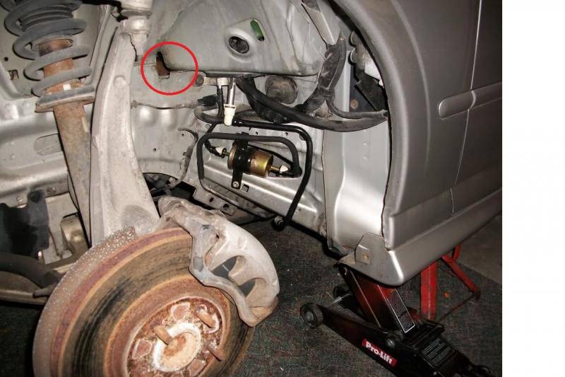

Another trick to getting the lower hose off is to:
wrap a shoe string around the lower hose, and tie a knot.....
feed the string through the wheel well and pull on the hose.
After about 3 hours of trying to get the lower hose off with channel lock pliers, my dad and I were able to pull the hose off in about 5 minutes once we got the string on the hose and pulled.

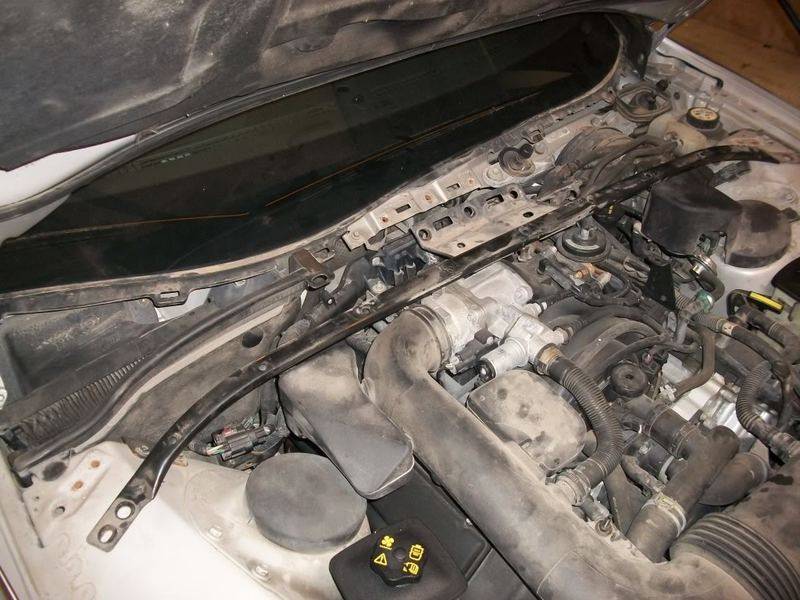

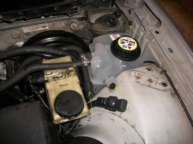

I have seen a few people asking about a how-to for the degas bottle (coolant reservoir) replacement lately. I haven't seen a write up myself so I had some free time and figured I would make one up. This is not a difficult job at all, it took me around an hour or so with bleeding the cooling system. I hope this helps some people.
1) Drain the cooling system according to the tech article How to Drain the Lincoln LS Cooling System

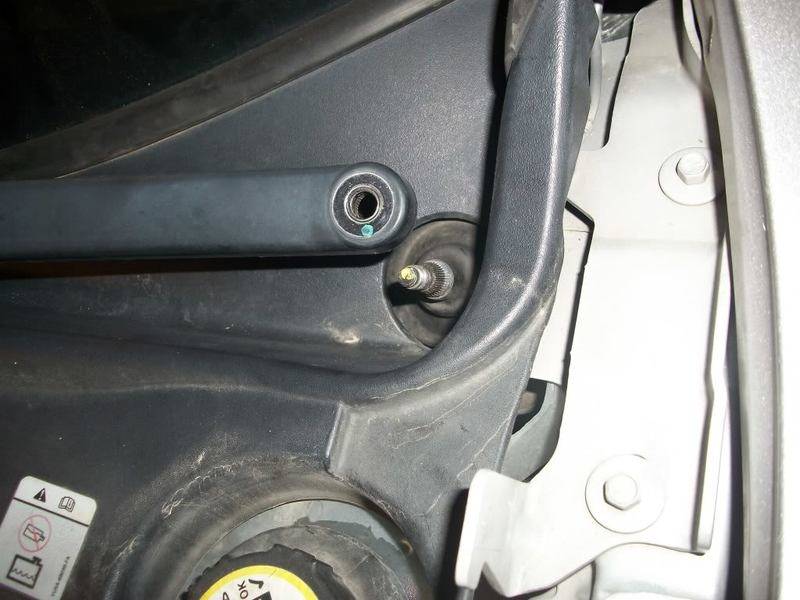

2) Remove the windshield wiper arms. Pull off the rubber cap and remove the nuts. Pull up and down gently on the arm until it comes off. You may want to mark the position of the arm before you remove it so you can replace it in the exact same position.

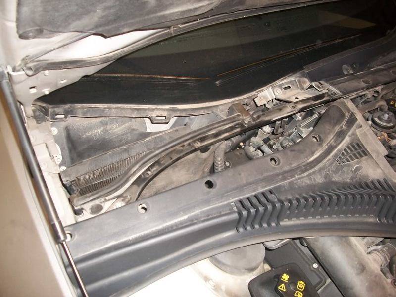

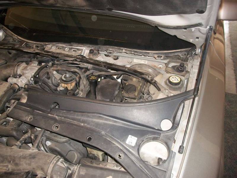

3) Remove the pin clips that hold the cowl covers on. Push in on the center and they will come out. Remove both cowl covers

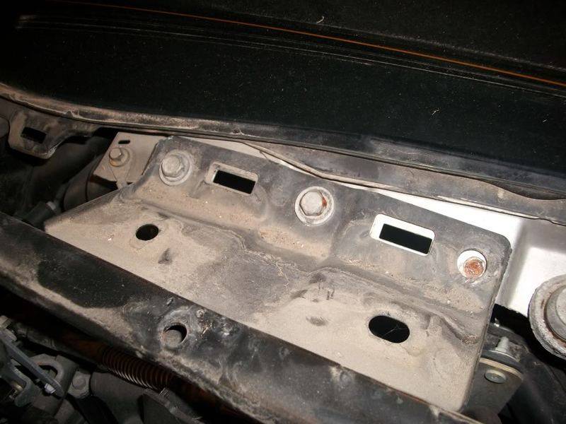

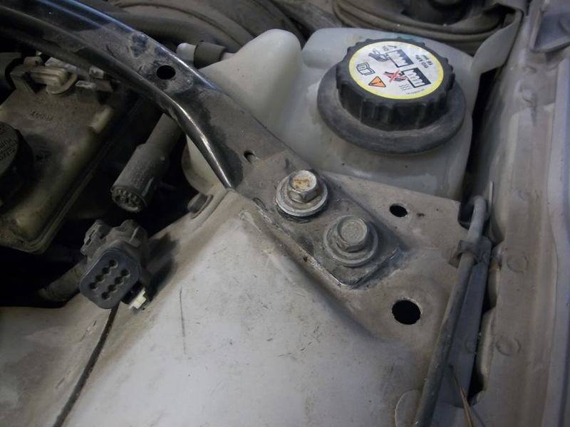

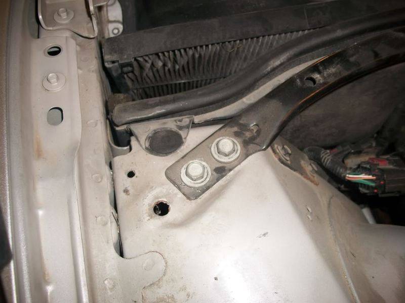

4) Remove the 7 bolts holding the strut tower/firewall brace and remove the brace

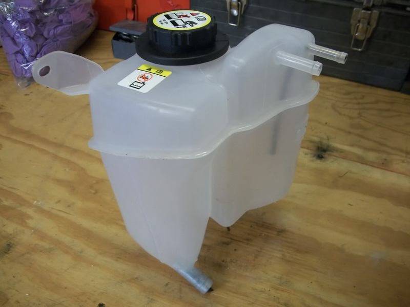

5) Remove the 2 bolts and 2 hoses on top from the degas bottle. Leave the bottom hose attached to the degas bottle

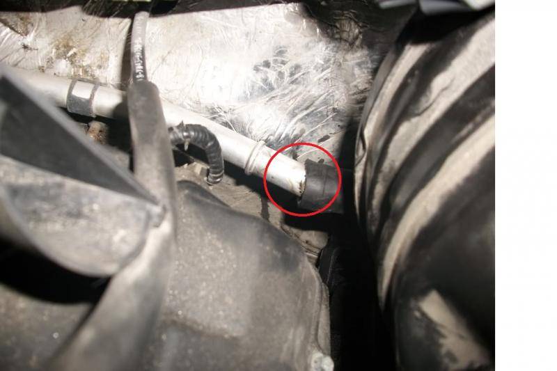

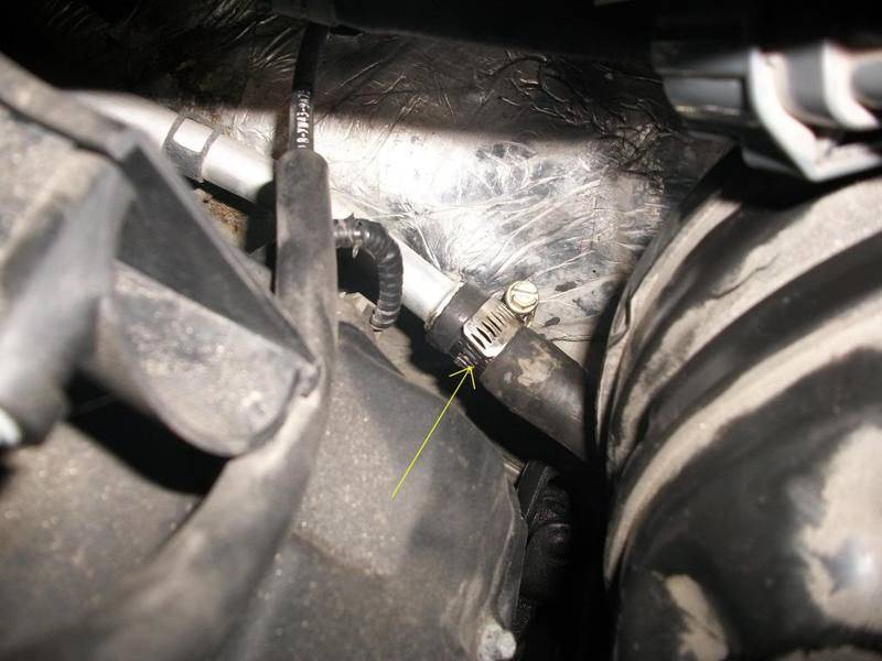

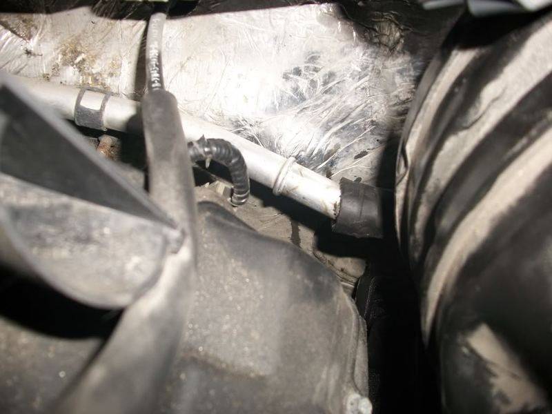

6) Remove the pinch clamp on the lower hose from the heater core pipe located behind the drivers side valve cover. I would throw this clamp in the trash and use a regular wormgear hose clamp. The factory clamp is hard to put back on considering its location

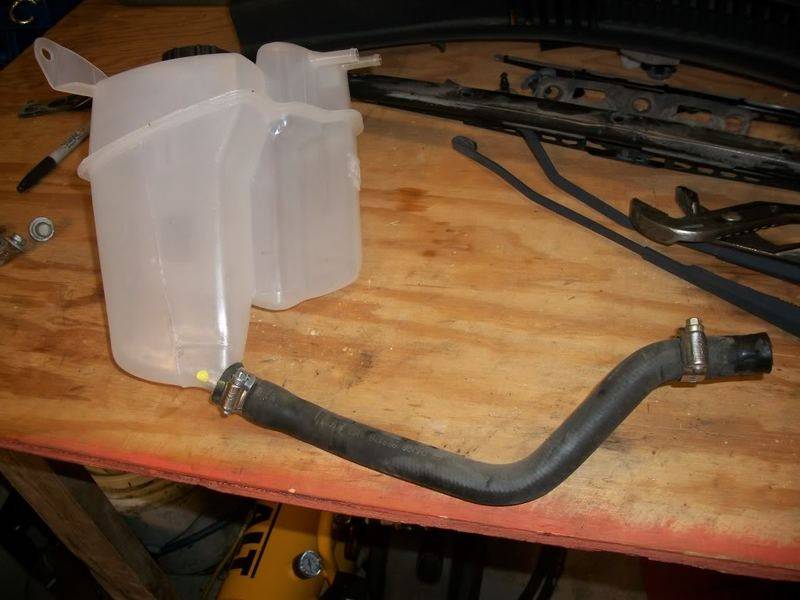

7) Install the lower hose on the new degas bottle in the same position as the old bottle
8) Install the new degas bottle and connect the lower hose to the heater core using a worm gear hose clamp to make it easy
9) Re-install the 2 degas bottle bolts, 2 upper hoses, strut tower brace, cowl covers and wiper arms
10) Fill and bleed the cooling system according to the tech article referred to in step 1 and you are done
I'd like to thank you for the in-depth instructions given on changing out the degas tank. The pictures, especially #6 (THE hardest step due to lack of access), was the most helpful by far. The link for bleeding worked like a champ! Having such knowledgeable folks on these forums gives us noobs a real leg up on repairing our babies! I got extremely lucky in that my tank lasted 174K miles before having to be replaced. Thanks for sharing your knowledge with us all, it saved me about $500 from a shop doing it! Oh, and whoever suggested the long-nose Visa Grips gets a double gold star!! The spring clamp was easy, getting the hose off and back on again is where all my time was spent. Thanks much, again!!

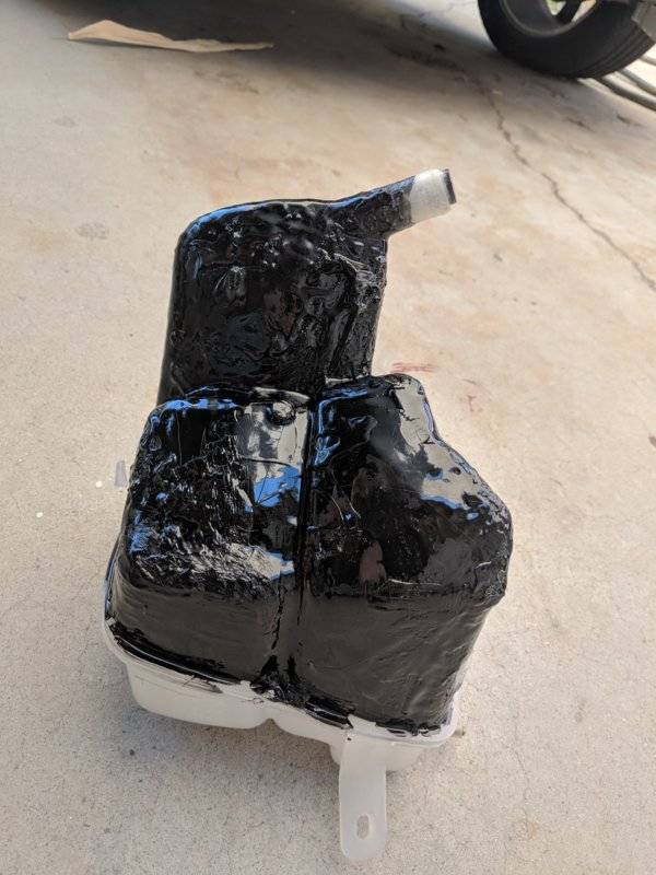

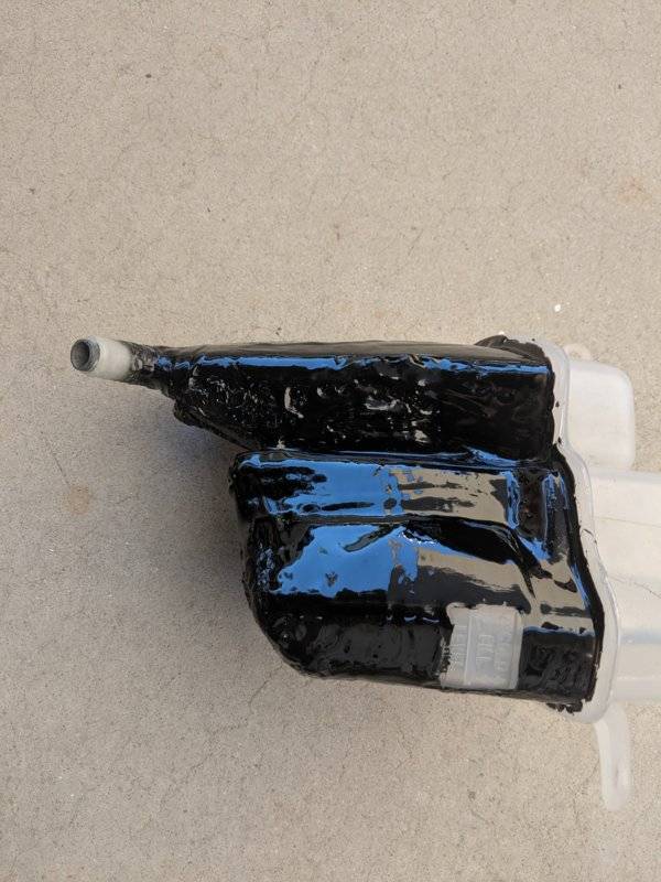

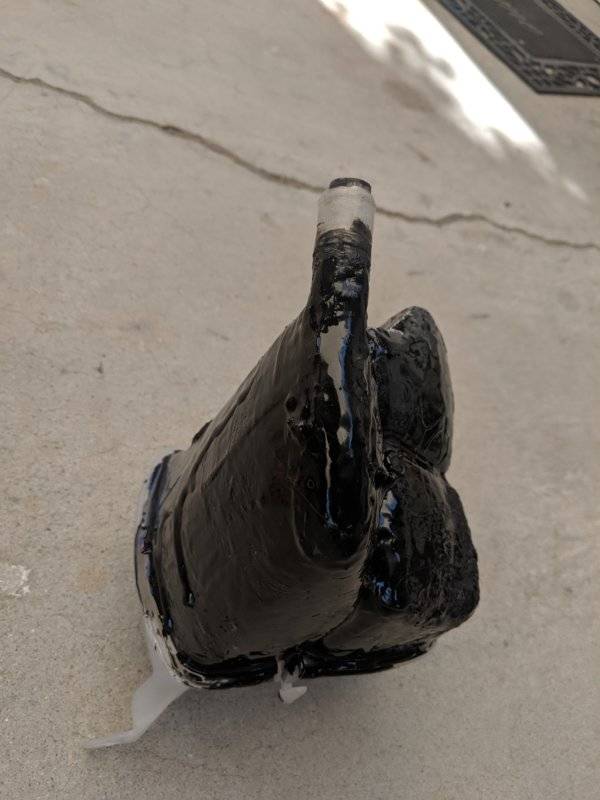

Previously I had walked into an AutoZone and saw that quite a few fix it products were on sale. So I grabbed four packs of JB Weld (Radiator Weld) Edition. It retails for $15 a package, but I managed to grab them a $4. I was thinking to myself "score"

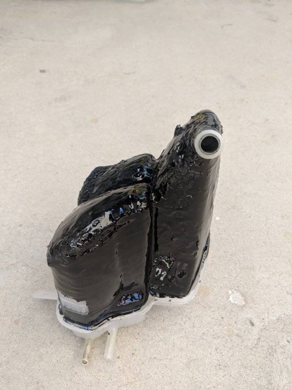

So I coated my new Degas bottle with this epoxy that is specifically designed to fix plastic and resist radiator fluid. So I'm thinking this will last longer than the original Motorcraft product for not even ⅓ the price.
The bottle flexes as it pressurizes and de-pressurizes. The epoxy will crack and flake off.

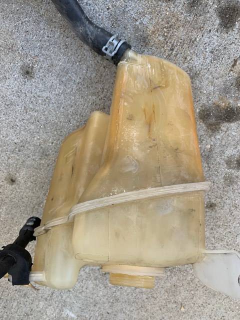

and I'm pretty sure the most common failure point on the aftermarket bottles is the seam where you cut off the epoxy...

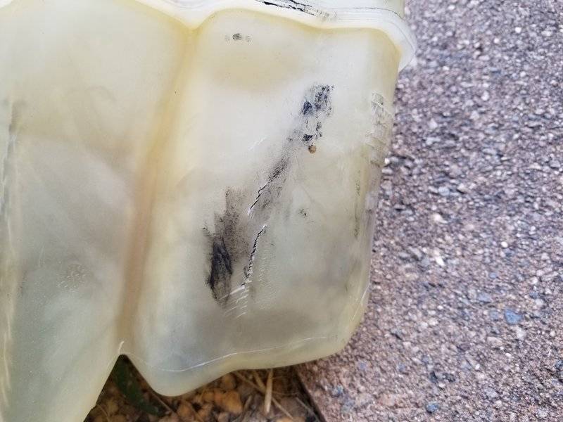

Maybe, but my two cracked in the middle of the body.
Not one of mine, but something like this:
Were yours Motorcraft? If not, I could be thinking of one particular "brand" of bottle, as I believe there's at least two types. One had the unique cap thread, one matched OEM
Motorcraft, the original ones the cars were born with at the factory. The replacements I used were Motorcraft too. So far, so good. (Note, we are talking about two LSes, each with over 200K miles now.)
I wouldn't touch Dorman or the others like it. I might be willing to try the Jaguar one.
Motorcraft, the original ones the cars were born with at the factory. The replacements I used were Motorcraft too. .
Yeah, I was talking about the aftermarket bottles being prone to splitting at the seam. That JB'd tank may miss the failure point entirely
