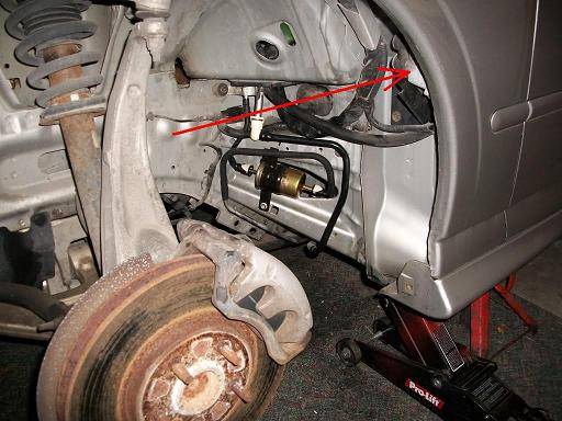

off topic, does anyone know what this is?

Is that the gen I cruise control module? (Wild guess...)
Well if it is, it would explain my cruise control problem (dash lights and buttons work, just no throttle action). While doing my front brakes, I noticed the top half of the aluminum turned to powder and fell off. I'll see if I can dig it up and make a new post. Thanks!
Hey...thats my car...lol. I never noticed what that was...I didnt notice anything out of place or strange when I had the wheel well open. I will check when I get home and let you know

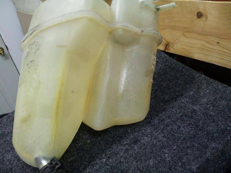

Thanks for the write up Hite! I was able to replace my degas bottle last weekend with the help of your guide. It was starting to go as you can see in the pics, little cracks on the bottle.
No problem, I'm glad this writeup has helped so many people. All the bottles I have seen have had cracks in the same place as yours.
