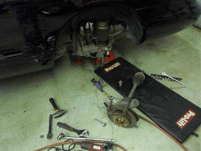

the 255 install isn't bad... we did a 255 pump, 4.10's, and 93 driveshaft in one night... btw one wheel method FTMFW!!!
I remember how much of a PITA it was doing the driveshaft last time. So it is probably a good idea to do it all at once. Didn't help I had the gas tank resting on my chest, and it was a full tank too...sucked having to bench press it back into position. This time I am doing it on a nearly empty tank.
Main issue will being able to get the diff up there since my Mark is my only car. Guess I need to bribe one of my friends of brother. :lol:
Agree the one wheel method makes life so much easier. I swapped in the FRPP pumpkin last time, was a pretty quick job.
