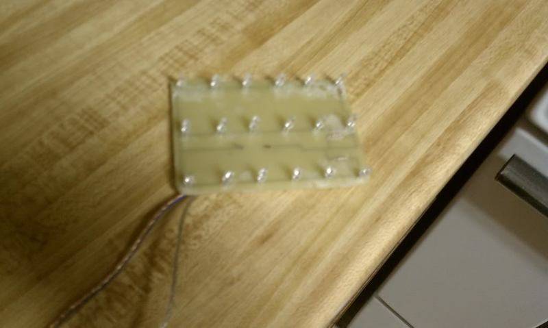

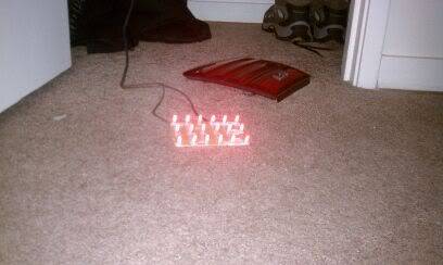

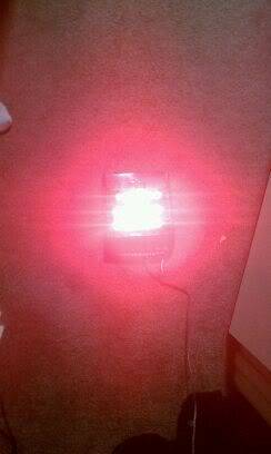

It has the contours as well and your right it doesnt project a perfect pattern.
It has horizontal 'lines'.. If you can line the LEDs up with those (that's what takes me so long when I'm designing), it comes out pretty damn clear.. :)

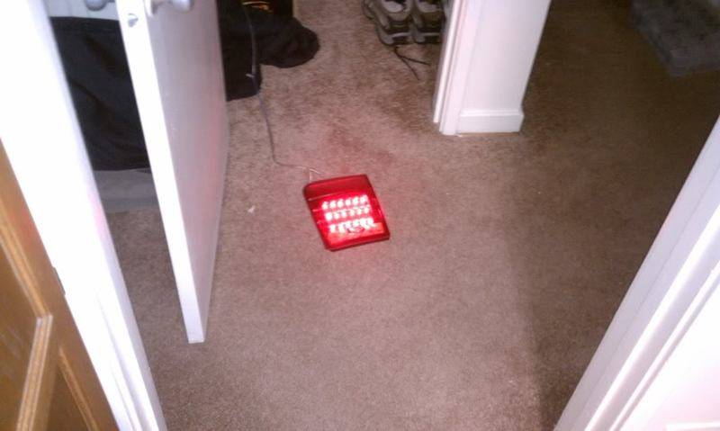

I'll grab pics of the board I made that was too big..

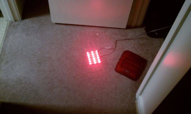

A few pics for your enjoyment.. :D

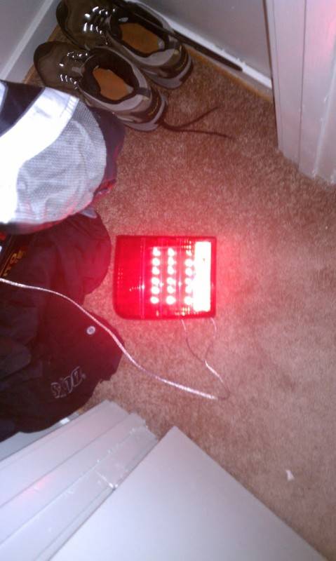

Whoa!! that was really deceiving... In the first pic it looked so small. Where did you get all of the parts? Online?
"All the stuff" being enough for one light or all four?
Fast...don't tap out. That looked like it was going to work out pretty good! Do you have the lights at different levels or was that just the angle of the camera shot?
Thoe look real good fast. What about making a top strip of lights for the turn bulb, on both lights.
You mean for the inners? Well if Villa would tell me how he got the housing separated from the lens, I might be able to do it.. Right now, I just cut the reflector bowl..
The 100 is enough to do all 4.. But you have to buy a transfer paper and design them.. Then etch the board..
Yup right between. I removed the foam gasket like material around the outside first as well with a knife.
