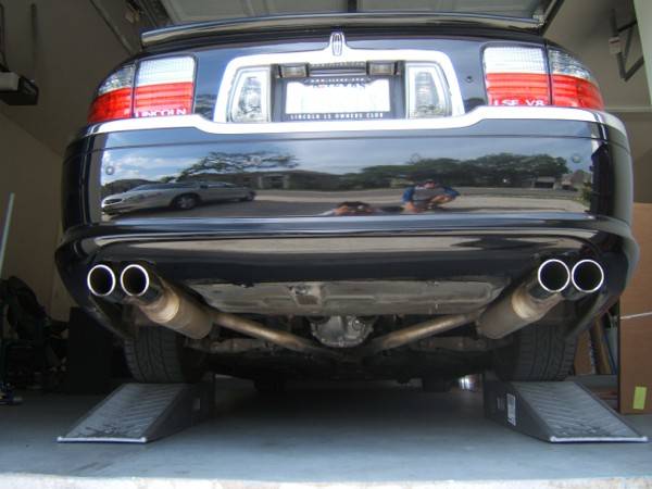

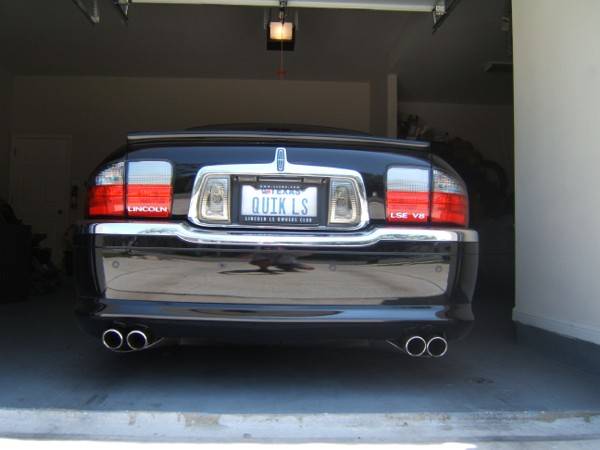

Here's the pics -

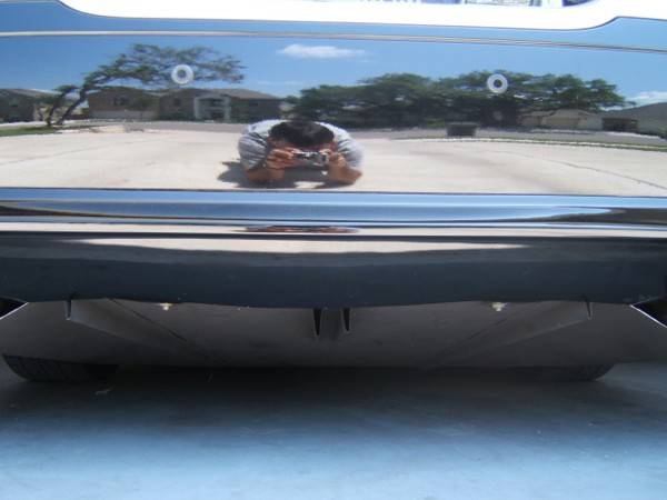

Look Above it is a pic (in the bumper) of the infamous Quick.

I did the custom thing - very happy and only $450 in parts
2 x 42443 (flowmaster super 40 muffler) $80.99 each
1 x MAG X-PIPE (magnaflow x-pipe) $89.95
2 x MAG TIPS (magnaflow dual double-rolled tips) $49.95 each
2 x CON PIPES (2.5" piping) $29.95 each
2 x EX-PIPES (2.5" piping) $14.95 each
labour $150.
