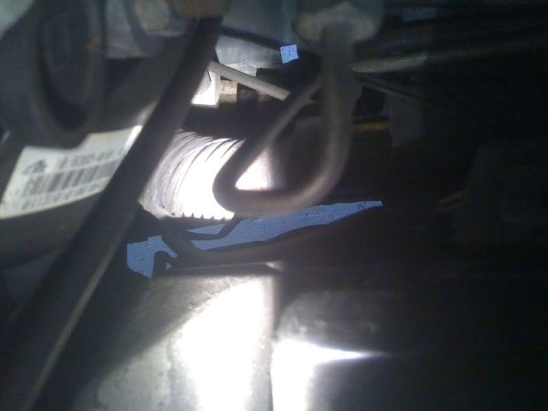

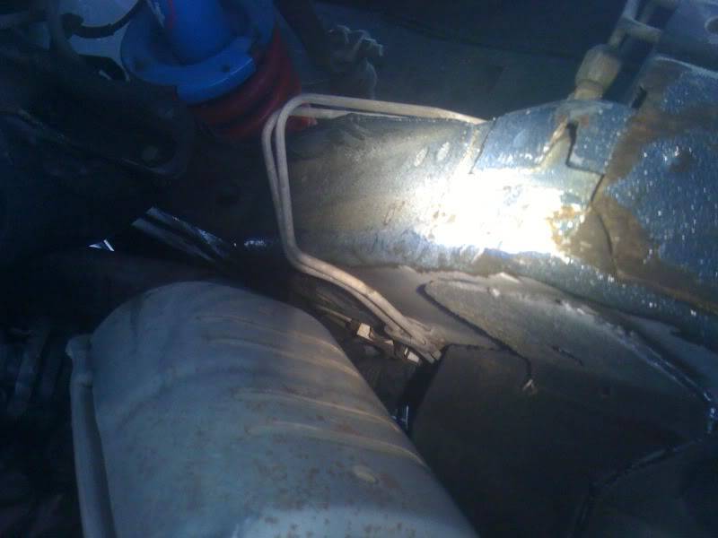

I took my 93 in at the end of last year to get the recall done...last week I noticed my brake pedal was spongy so I bled the brake system, there was alot of air in the rears, after the bleed everything seemed normal, until today when the pedal went to the floor...got to my shop and got it on a lift and found the leak, it's coming from the recall switch that Lincoln installed, so I went to Lincoln during my lunch break and they told me that the recall was done (no kidding) and now "the case is considered closed" even tho the part that THEY installed is making my BRAKES leak!!!

I can't tell what I'm supposed to see in those pictures. I would definitely keepmpressing the issue. They should fix it. If they'll replace a 16-year old
Switch for the recall, they should definitely replace one that they replaced it with if it's defective.
First, is that under the master cylinder? 93 is the ONLY year where that is located, no in the fender like 94 up. Hard to tell with the pics.
Second the switch only gets replaced if leaking. If not a inline fuse it added to the harness.

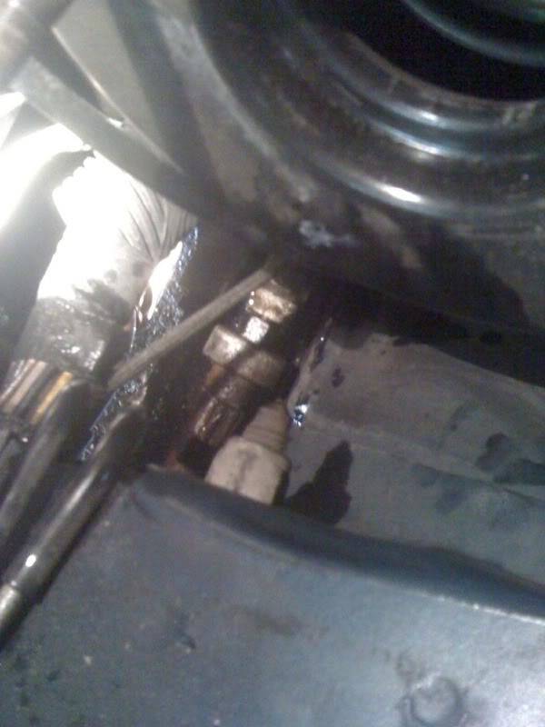

Here is the leaking switch..it it located under the brake booster on the 93s

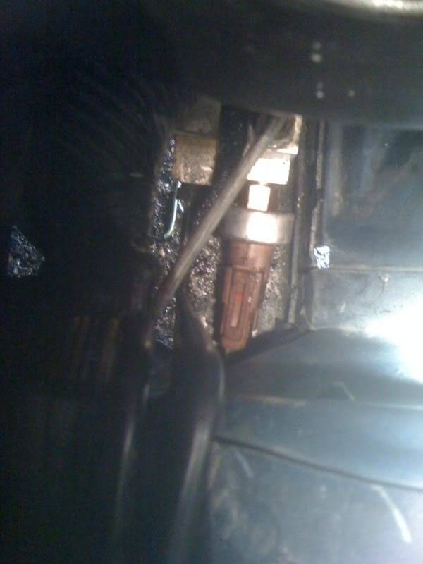

removed the master cylinder and removed the faulty switch

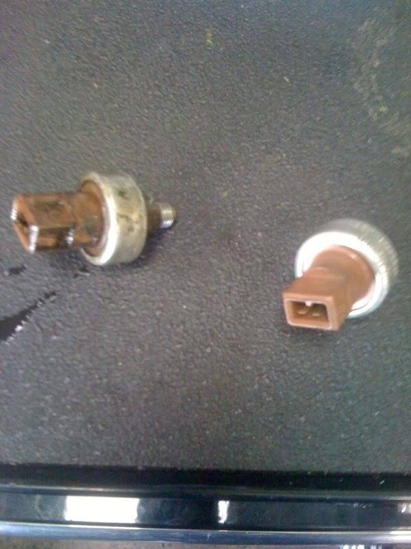

installed new switch
if you notice the stud and nut on the strut tower, that points at the brake booster, that is the PITA nut for the UCA...so since it was easy access now, I replaced both UCAs while I had everything apart, reinstalled master cylinder, bled brakes, threw wheels back on and DONE...rides awesome...and I can STOP again

ok ive done hundereds of this damn recall
if the switch is not leaking, all you get is the double fused jumper harness
if it is leaking you get a new style switch and a unfused adapter harness to fit the new stlye connector on the new switch
