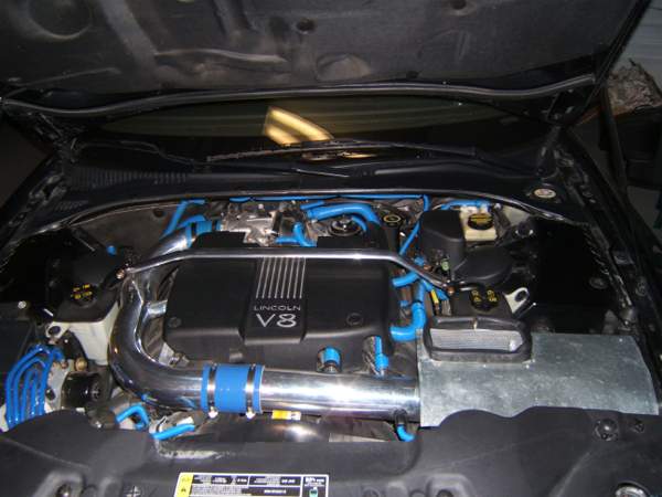

Added some blury pics of my new ride :)
not yet - tonight I should finish with test fitting the chager and manifold.
got to see if my air tube will clear the charger pulley and see if it will all tuck under the hood.
if not we may have to reroute the air tube - which will change the intercooler design/placement.
BTW: car looks good and clean :Beer

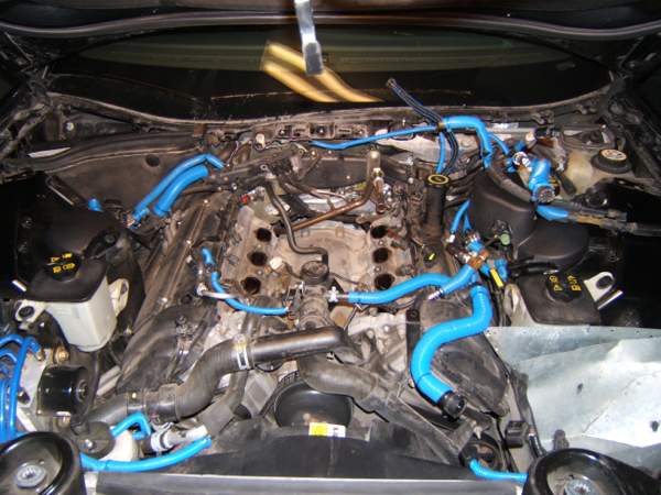

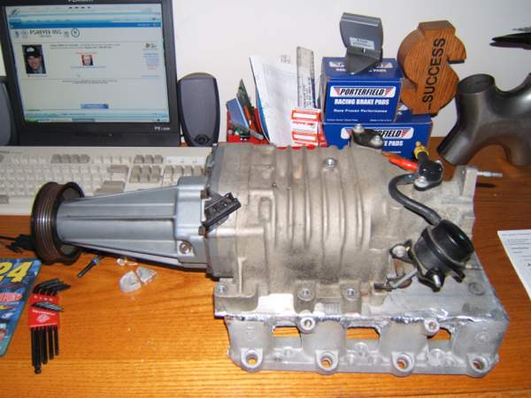

Well - started....
Here's some pics.
1) Starting shot - all pretty.
2) Ending shot - stock intake manifold out.
3) mock up Eaton with the 'rough' intake manifold
Next steps are to trial fit, grind, cut, fit, grind, cut, ....etc

haven't tried to test fit yet - but eyeballing it - looks like quit a bit of fighting for space. The cooling tower, the rad hoses, hydralic fan hose, ....etc
not alot of room.
but it's fun looking at the 100 or so pieces of my car on the garage floor :wrench
