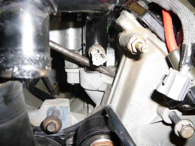

After messing with plenty of these, I've found the easiest way to get them out of the heads is to carefully pry up against the sensor bosses with a screwdriver. Remove the sensors before doing so...this pic was taken just to show where to place the screwdriver.
