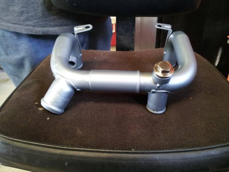

So I go to work on getting off the cross over tube cap,
The previous owner has the head of their old 1/4 drive stuck in the opening, which he attempted to drill out and the opening is all screwed up and most of the head of the 1/4 drive is still in there. I have sprayed it with lube, heated it, hammered it, used robo grip large wrenches, and large pipe wrenches, and nothing happens. It even looks like the previous owner had tried the same thing since the side of the cap is all chewed up and in some spots you can barely see the difference between the metal on the cap and the metal on the tube its so bad.

as far as the crossover tube, get a new one. the one you have sounds screwed. should be someone around here who can get you one soon-ish.
You can always weld a nut onto the cap since it is screwed anyway. Just get good penetration and then you have something to work with.

If the hammer method fails, find a shop with a wire feed to get a nut welded on the top of the cap.
Remove the hose directly under the cap...spray a lubricant at the bottom of the cap. I've got several cross tubes laying around. For the right price it'll come with a polished and cleared lug cap

When I look at the cap from the side, you can even see where it fits on the crossover tube as it looks like its all one piece at this point!
The caps lip is only 3/16" thick. You can usually grab it with a good Pipe Wrench, not regular pliers. Doubt your seals have survived if you've heated it to glowing red, which means you'll need to remove the tube and replace all seals, there's 4 total

The cap is the highest point in the system... you may try to lift the left side of the car and burp out of the bottle(just to get it to a close shop) . No you wont be able to burp thru any of the hoses.

by the way, you do have to turn this cross over tube cap "counter-clockwise" to get it off right? not clockwise?

Yes, the cap comes off CCW. :rolleyes:
You really need to find a good mechanic, because you shouldn't be working on the car. :p
Counter clock, its a right hand thread.
