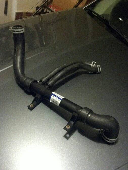

Finally got the replacement hose in the mail
NAPA was gonna try to charge me $119 and found exact same new one for $50
Keep an eye on that belt, looks like it took a little abuse as well.

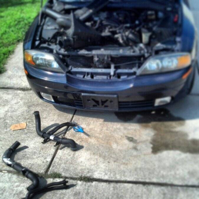

I tried bleeding coolant system and no luck there. While test driving it, it over heated of course but I quickly looked under the hood and found the culprit
The plastic bracket holding three lower radiator go hose snapped and has been grinding on the power steering pump (explains why my power steering gives out randomly) and the metal pulley was grinding against the lower hose puncturing it.
You've still got air trapped in your system. Did you add coolant through the thermostat housing or just the degas bottle? As joegr already pointed out, the air pocket is preventing the coolant from circulating which results in overheating and boiling of the coolant.
