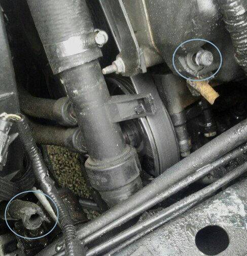

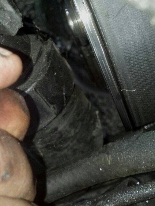

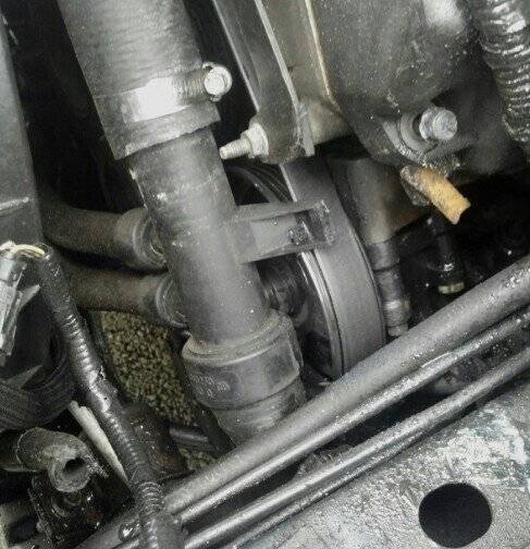

I tried bleeding coolant system and no luck there. While test driving it, it over heated of course but I quickly looked under the hood and found the culprit
The plastic bracket holding three lower radiator go hose snapped and has been grinding on the power steering pump (explains why my power steering gives out randomly) and the metal pulley was grinding against the lower hose puncturing it.
Wow what a mess. What's up with the open hose, top pic, lower left hand corner? Looks like it is the oil cooler line and that it was cut, which I assume means that those two hoses hanging under the one that broke loose are looped to themselves?
I have no clue I was looking at that too trying to figure out what it was and why it was cut like that
You have a 2001, right? Electric or hydraulic fan? If it isn't an oil cooler hose and you have an electric conversion I'd wonder if that isn't a hydraulic fan hose that was just left in.
Notice also that the lower radiator hose (the one that has failed) was repaired/modified in the past. Someone cut part of the long plastic pipe off and added some radiator hose and clamped it to the cut off pipe. From the factory, it is a single assembly of a pipe with a hose on each end and the two oil cooler hoses in the middle.
It's an 01, and I'm not sure. I'll find out tomorrow when I bring it in the shop
Ok that explains alot Thanks, when I was searching for the hose all of the ones that came up looked nothing like the one I have
hose n' bolt
plug the hose with the bolt?
That's the lower hose for the oil cooler. If you have the oil cooler (those two smaller rad lines go to a doo-dad that the oil filter screws onto), then that's the right one, although that specific one has been butchered. If those two lines coming off the plastic housing don't go anywhere, then you can get the non-sport lower rad hose.
The other hose that's hanging out there is something else, looks like the low pressure hose used for the power steering, hydraulic fan, and tranny cooler.
