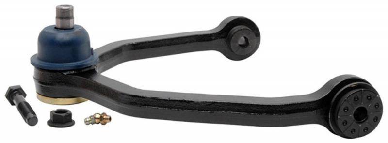

Went to National Parts and got AC Delco uppers. Both have grease fittings and look stronger than the stockers that came on my latest Mark.
Well I shipped the mis-matched Moogs back yesterday.
I really want to try the Dormans ($50/pr shipped via RA-Cheapa$$ in me) because the car's just plain old. Highly considering the Raybestos Adv Tech arms now. Guess I'd much rather do it right the first time to save me more down time and another alignment down the road.
The Rays look Beefy:
