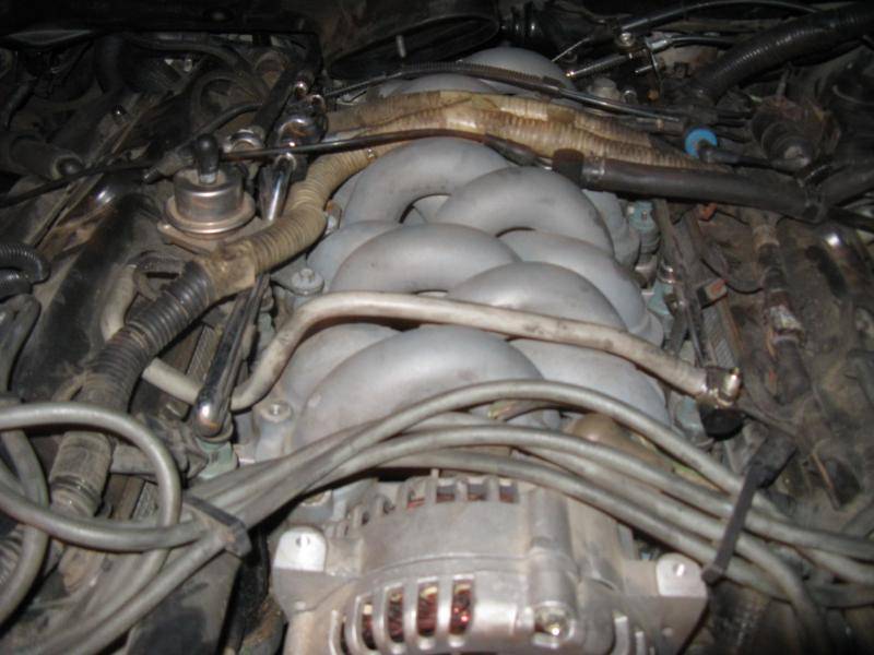

So I bought this 95 LSC about two months ago. Runs great except for taking quite a few cranks to start. Battery, plugs, fuel filter, all good. Hooked up a fuel pressure gauge and while running it's at about 30psig. I pulled off the vac line from the FPR and it went up to about 40psig. I left the car running for a bit and when I shut it down, the pressure immediately dropped.
So here's my dilemma. I decided to change out the FPR, so I ordered one from Carquest for a 95 LSC. When I took it out of the box it did not look like the one that was on my car. The one on my car was a 3-bolt and the one they claimed was for my 95 was a 2-bolt. I called 5 star ford in Scotts, AZ and they gave me the same info. So I read the part #F2LE-9C968-EA off of my FPR and it's showing it's off a town car possibly. The guy at Carquest ran the # and said it cross referenced to Chrysler or Dodge. WTF?!!
It's a 3-bolt triangle shaped FPR. Were there any Mark VIII earlier models that had the 3-bolt? Is there a possibility they put a 94 engine in at the factory?
