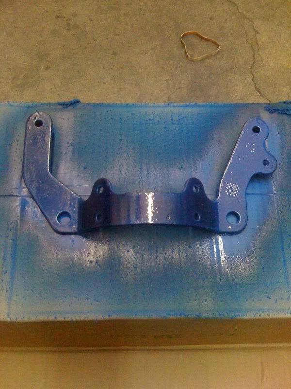

here is the one from my 93, i think the one you found is for a gen2, i know Lasers was like that before it got "customized" for his blower
the studs on the rear of the bracket are longer because they are also the supports for the intake resonator, once you delete the intake you'll no longer require those long ones..
Glad you found another one, you can probably buy the one from the yard cheaper than shipping mine would be

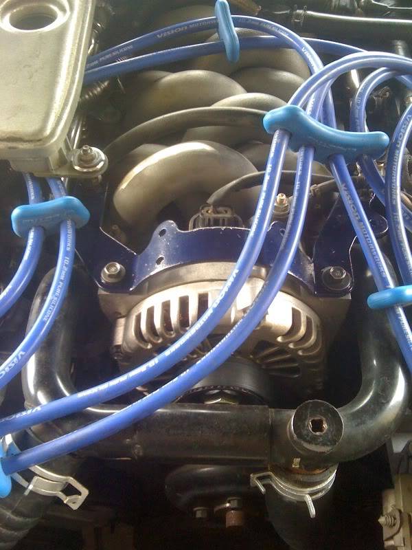

If you look at that one pic of the bracket I laid on the alt and you will see a bolt hole in the intake...so I'm guessing the bracket I have is the wrong one. So the bracket I have mounts on a longer stud that is welded onto the bottom of the crossover tube which I can see from your picture. So I still need the extra one you have.
1st gen bolts to the intake, 2nd gen bolts to the crossover, either bracket will work
the brackets only function is to keep the alternator from rocking forward on the lower bolts that screw into the block, which is a big deal
with the revised intake on the 2nd Gen, it wont have the longer studs for supporting the intake tube, since its shaped and routed totally different
so if you plan on doing the intake resonator delete ( which you should) then a Gen2 bracket would be perfect, would look alot cleaner than the one i have
i havent fully deleted my intake resonator yet.. too much other stuff going on right now, i took the larger section off that fits to the hose on the rear of the intake, and found a gauge that fits in the hose just to act as a plug
-shrug- i know thats the style a 2nd gen has, why it was on a 94 i dont know, but it will still work, all the ones ive seen on 1st Gens in salvage yards are exactly like mine.
i would rather have the 2nd gen style like the one you found, as i plan on doing a 96 Cobra intake one day, and i dont believe the Cobra intake will accomodate the style bracket i have
Looks like I just need to change the studs out for longer ones.

almost looks like you have broken studs, also sapp, you need to stop spray painting and get into the powder coating business
:slam: that aint for a gen2, we aint got no damn plug wires!
looks like the studs are broken or someone put them in the wrong spot, just get some longer bolts

Well it's not a standard gen 1 bracket, so it's either a revised gen2 to accomodate plug wires, or it's a conti... Factories do all kinda of car chimera-ing when some parts run short
