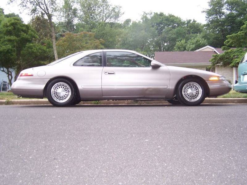

Here are some pictures.
Whole Car 1.5" lowered

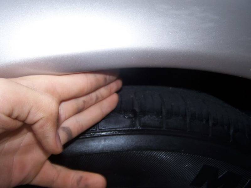

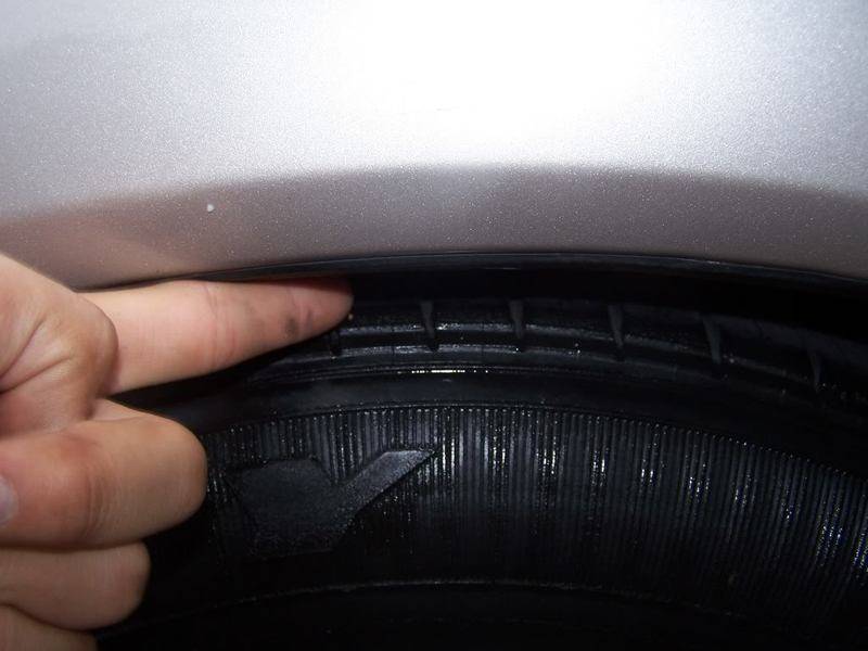

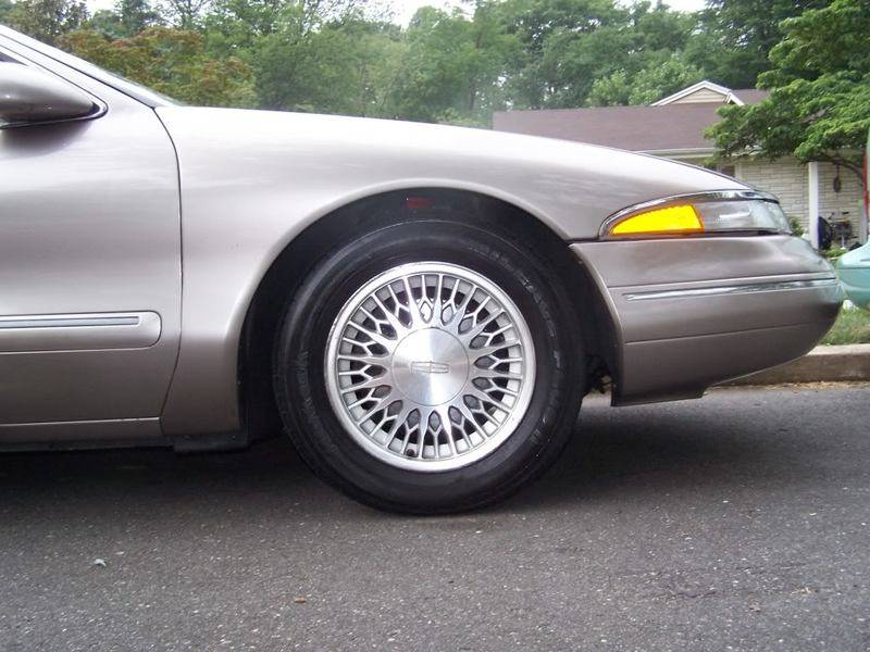

Front-Like 2 1/2 Finger Gap

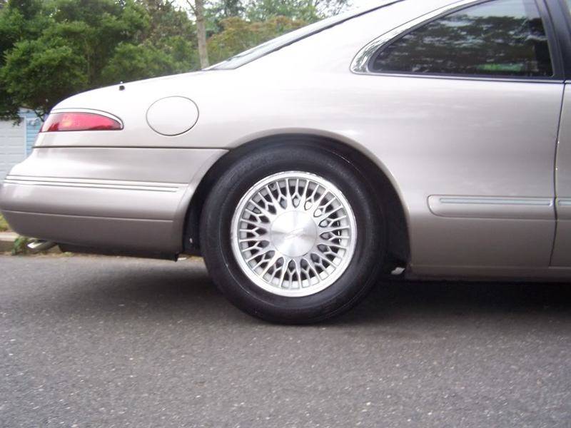

Rear-1 Finger Gap

I'd give Eddie a call but I would be surprised if the front doesn't lower more in a few weeks.
Yeah, I wouldn't do ANYTHING until "at least" 14 days. Because of the weight of the engine, the front springs will always be a little more stout and would be the last to settle.
