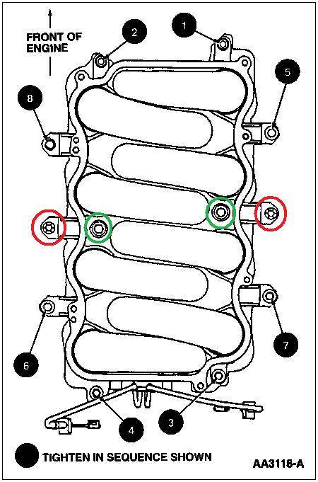

Lower: 15-22 lb-ft in the sequence shown.
If you have the two bolts circled in green, they also are torqued to 15-22 lb-ft. Early Cobra intakes have these two bolts, later intakes do not.
The smaller bolts circled in red are torqued to 71-106 lb-in.

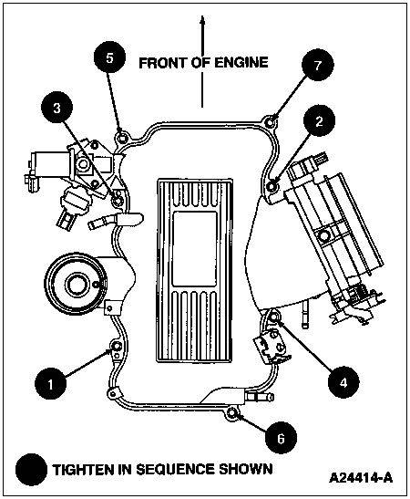

Upper: 71-106 lb-in in the sequence shown.
