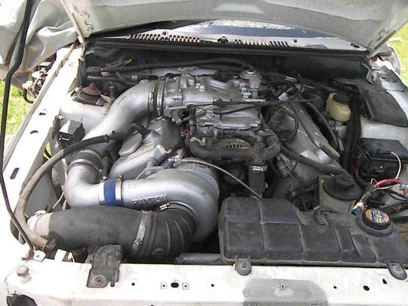

This is all strange, and I am going to have consult my mechanic. The above picture I took is from a Cobra that was brought into his shop about three months ago. The customer was a 25 year old girl and shortly after she took it the supercharger went out. She couldn't afford another one. The heads were redone with racing cams and was real lopy. She didn't want all that, he bought a used 97 Lincoln Continental motor and put the heads on that block. New manifold gaskets, and she was on her way a happy customer. So to my knowledge, the Continental has B heads.
Continental is also FWD and the block would not work in a Cobra, so it is not a Conti engine in it. If he is trying to tell you that those are B heads with that intake, he is FOS. Now if you are talking about he took Continental heads off and put them on the Cobra, then that would have worked, but still would be C heads and not from a 97 but a later model.
yeah I think you read it wrong! That is what he means! The guy took the heads off of the conti and put them on the block in the picture!
Definately a C head... you can put the whole C head engine in the car and be good to go tho.

Contis after 2000 have C heads and if he put Conti heads they are 2000 or newer.
Now G, I know you want to have a blown Mark at some point so do it right. Buy a set of C heads and screw the Cobra B head intake. Aint worth the money IMHO. Then get a complete 03/04 Cobra blower setup. You can get C heads for under $500 from Gear Heads in Arlington. The complete blower setup would be under $1500. Yeah install will be more due to cam timing and all that but the result will be better. Nice intercooled positive displacement blower!

1999 and up Conti's have C heads;):
http://www.mustang50magazine.com/te...modular_engine/four_valve_cylinder_heads.html

99 was the first year the conti had c heads there is a 99 conti outside my shop in the loading dock. the rear tire was ripped off it in an accident, 70k on it runs mint the car is super clean. its my buddy's car i keep asking him to part it out so i can have the heads, its a certificate of destruction so its useless now!
