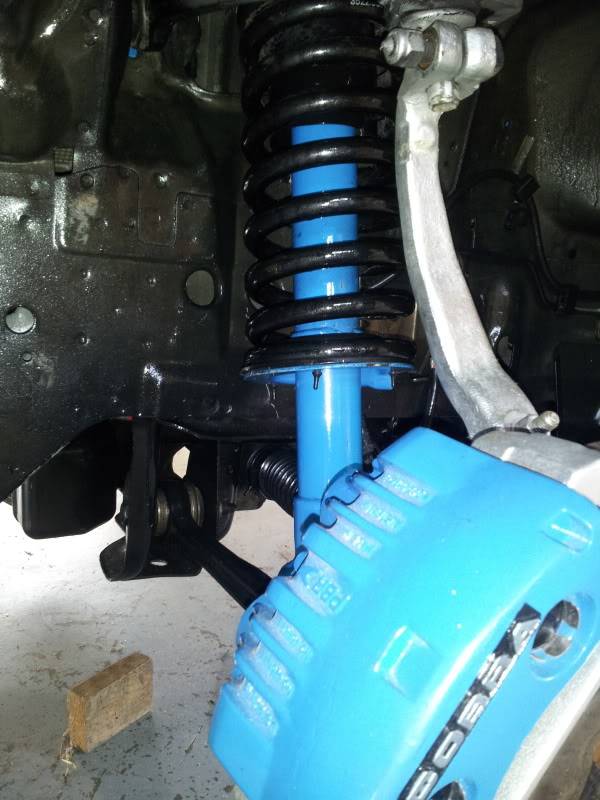

Sapperfire, I assume you have tightened that upper control arm bolt since the photo? Looks a little dangerous as pictured....

Yeah man, I just hung everything up to snap a pic, then everything came back apart for more painting.. then all back together and torqued
