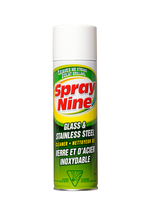

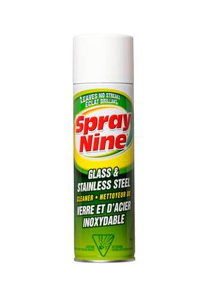

  19. RigsLS
    RigsLS Dedicated LVC Member
    Messages:
    7,761
    Likes Received:
    516
    Joined:
    Mar 10, 2012
    Odd this thread regarding cleaning interior glass comes up on my return from my latest trip.
    Two nights ago, I was driving the new Pete back hauling through the Canadian back woods when I felt the need for a little break & stretch.
    I had recalled I had pressed a couple of irritating black flies onto the glass while driving to get rid of them and recalled I should clean that up later (OCD)
    Also being heavy on the Vaping, with my 12 Monkey's Mangabeys E-juice, + regular cigarettes, the front interior glass does quickly within the week form a haze that can clearly be seen at night when passing past street lights. If you suffer from OCD like I do, you just can't help that clean is not clean enough.
    So I stopped ... and I ran this new cleaner I picked up across the front glass and cleaned it to a no streak finish in under a minute.
    I used to use Wurth saBesto premium glass cleaner, #0890 9026
    (not a product you'll easily find at retail level, more of a dealer or detailer item, hard to come by and expensive.)
    I had given up on this product since finding Spray Nine Glass & Stainless Steel Cleaner,
    this stuff works like CRAZY, comes out in a light mist that turns into a foam, no running, cleans perfectly with no streaks or spots.
    I've always been a big fan of the regular Spray Nine cleaner so when I saw this new Spray Nine Glass and Stainless cleaner on the shelves at the Peterbilt dealership out West of Canada, I bought one can followed by two more a week later.
    Haven't seen this item at retail stores just yet but I figure it won't be long, this stuff is somewhat new, where I bought it they had to still enter the SKU number into thier system in order to ring me up, said it wasn't supposed to be on the shelves just yet.
    I guess it's a very new product.

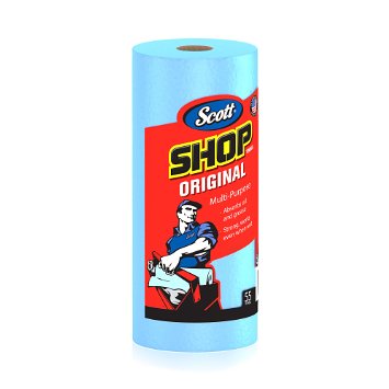

    I always have on hand and only ever user Scott Shop Towels to clean glass with.
    If there is a lot of gunk on the interior side of your glass I can see a second application may be necessary.
    Things to remember:
    1) Always clean at evening/night time, no sense trying to buff some glass clean in direct sunlight. Cold glass cleans better.
    2) try placing the vehicle with a street light shining inwards toward you while cleaning inside glass.
    3) expect to repeat the process for best results, your not always going to get it completely clean on the first go.
    I currently swear by Spray Nine Glass & Stainless Steel Cleaner, this stuff simply works period. No Fn'ing around, spray on a light mist on entire glass, allow to foam up for a few seconds and begin to wipe clean with the blue Scott Shop towels.
    Making sure to turn the towel over a bunch of times as not to wipe with dirt. Continue a second light mist with a second set of clean towels.
    I'm very pleased with this latest Spray Nine glass cleaner product, so much so, that I showed my wife how easily and great it can clean things around the house also :p
    Oh and when I did stop and cleaned the glass the other night, when I continued onward, I had to convince myself there is actually some glass in front of me, so clean it looked like I was missing a front windshield.
    You can choose to [​IMG] around with alcohol mixtures, vinegar possibly even ashes from your fire pit OR you can simply invest in a real good foaming action glass cleaner and be done with it. (don't clean warm glass with any product, always clean cold glass)
    Good luck.
    [​IMG]
    Spray Nine Glass & Stainless Steel Cleaner brings out the sparkling shine in glass, stainless steel and other metal surfaces. Its foaming action is ideal for cleaning vertical surfaces. Use it to remove dirt, soil, dust, fingerprints, smudges, light grease and more! Leaves a refreshing lemon scent. Contains no harmful Chlorofluorocarbons (CFC’s).
    Use on:
    Windows, mirrors, stainless steel, chrome, and more!
